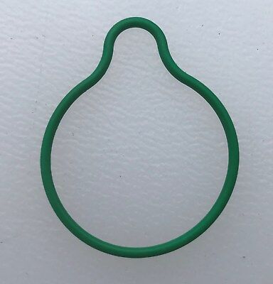

Changed my oil this morning and noticed a green oil on my oil pan and around the bottom of the ac compressor, so I guess my ac compressor is starting to leak oil. The ac is still working, but I noticed the pass couple of weeks the clutch has been going in and out. I guess since I caught the leak before the compressor blew, I can just change the compressor, dryer and o-rings. I have a vacuum pump and gauges.

You can very probably do much better than that. It is very likely that your leak is the same as most everyone else's, the o-ring for the scroll control valve. It's a sub $10 part, and you can change it out with the compressor still on the car. (It's behind the cover held on with two bolts at the back of the compressor.

Ok, replaced the o-ring, that was not fun. Replaced dryer with a Ford unit added 1.5 ounces of PAG 46 oil to the dryer. Pulled a vacuum on the system, no leaks. Tried to add r134a...when in the hell did they change over to SELF SEALING CANS!!! My mastercool can adaptors didn't work and to use the adaptor that puncture the hole in the side of the can (luckily I had one).

Changed my motor oil last week and noticed the compressor is leaking again. I guess the seal I put in was either not put in correctly or just started leaking again. Good thing I bought two of these seals. I am wondering if I should replace the metal plate holding the seal in place? My GOD a never ending battle keeping up with an aging car. Just replaced my starter again, car still will not start...again.
I ordered the Scroll Compressor Control Valve MC924I from Century Air, waiting for it to arrive. In the meantime been trying to find the torque spec for the two bolts holding the metal plate on, can't find a torque spec in the shop manual. Does anybody know the torque spec? I replaced just the seal last August but it started leaking again decided to place all of the components this time. Thanks
I just tightened it by feel, and that worked fine. There's no spec for it in the service manual, since they don't expect you to mess with it. I suspect it should be around 10 Nm.
