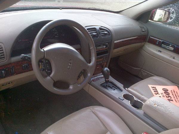

you can go to the junk yard and get the "tiptronik" shifter out of a v8 and its plug and play just replace your shifter. much nicer!
2000 Ls V6 160k
You mean this? Here is the interior the day of purchase. I was under the impression that the sport models had the shiftable trans and stiffer suspension.
5 auto Select Shift Transmission on this '02 V6 Sport

The transmission is the same with or without the select shift shifter. You can swap one in if you want. V6 of V8 doesn't make a difference here. I think that some PCM reprogramming is required if you want D4 to work correctly. If you don't care about that, then no reprogramming needed.
Yes, the sport models have some suspension differences, mainly shocks and anti-sway bar. They also have 17" wheels instead of 16".
