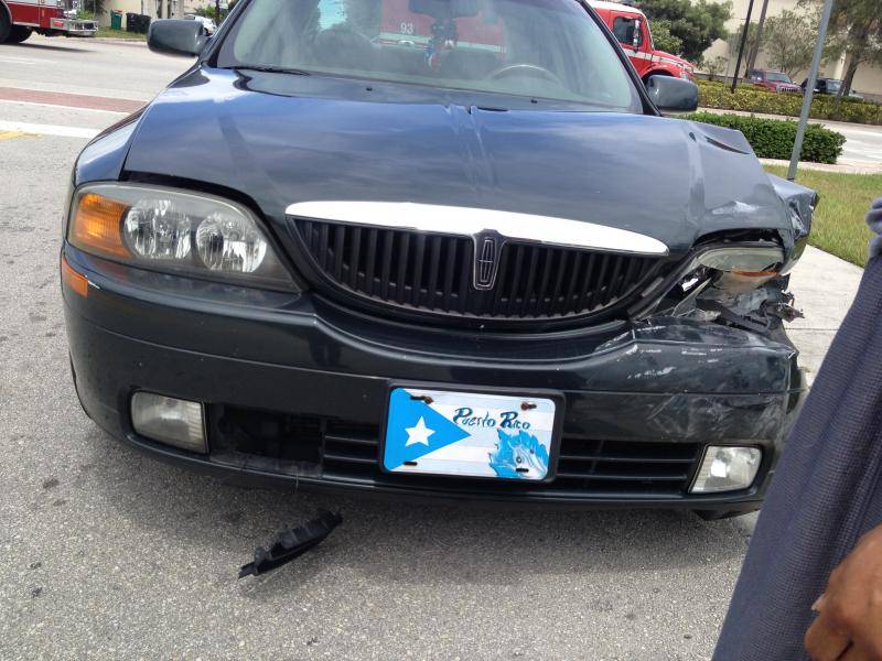

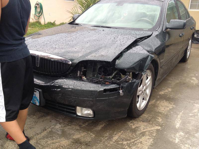

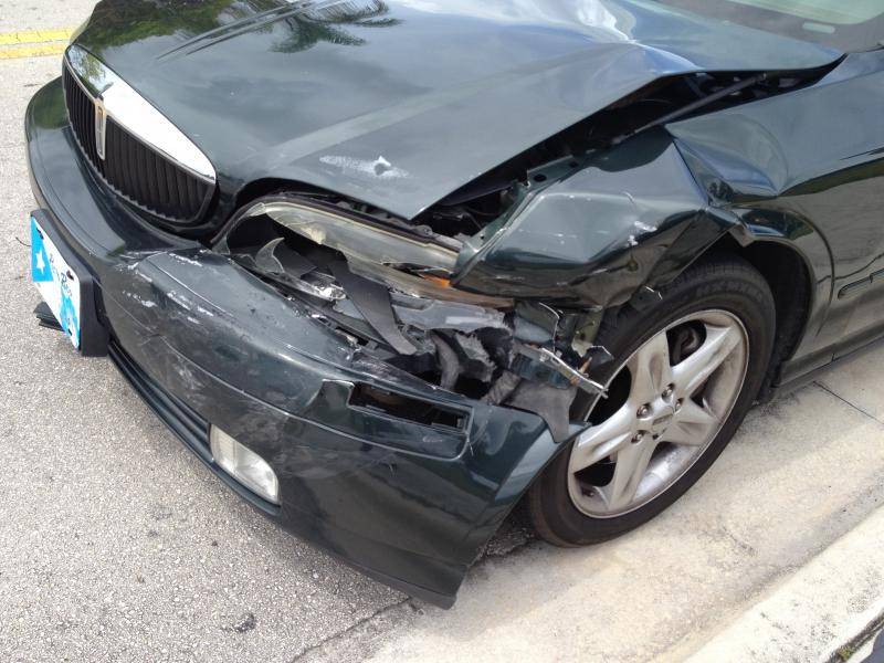

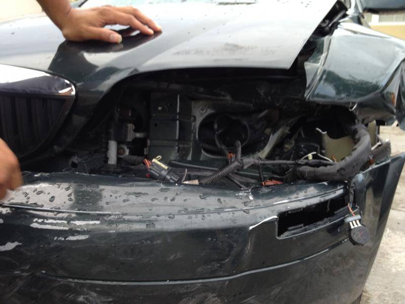

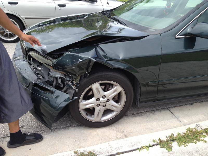

Yesterday I was in an accident due to a person running a stop sign, then fleeing. I was left with front damage to my 2002 lincoln ls. The whole headlight was smashed and ended up falling out, my fender is bent as well as my hood, and my bumper needs replacement. From how the headlight socket looks, I dont know if it will be as simple as just replacing it. Any thoughts? SEPTEMBER 7TH 2013 008.jpgSEPTEMBER 7TH 2013 002.jpgSEPTEMBER 7TH 2013 003.jpgSEPTEMBER 7TH 2013 004.jpgSEPTEMBER 7TH 2013 007.jpg

So there's no point in trying to fix it ?
That's up to you. Your insurance is probably going to declare it totaled, as in it will cost as much or more to fix the car completely than it is worth.
That headlight assembly alone is about $600 (HID would be $1200). You'll need a new bumper cover, new hood, and new fender at a minimum. There will also be some metal to straighten out.
