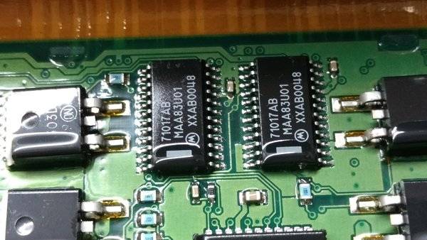

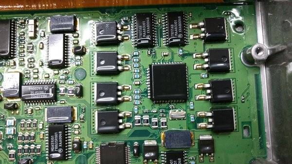

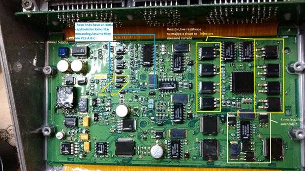

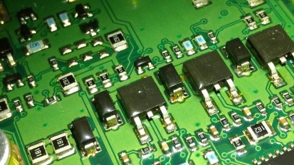

I took out the PCM for visual inspection,there are some photos.

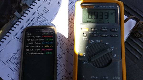

-After my research I tought it was something with a fried microcontroller or memory but No, it's a driver(transistor/mosfet, maybe some buffer circuits) in short or open state.

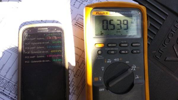

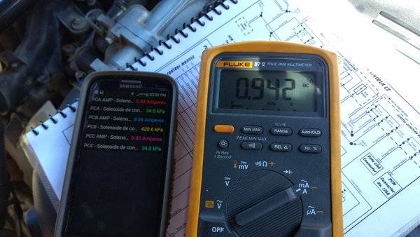

-I saw another case when they replaced the solenoid pack and still shifting bad,the Pressure Control Solenoid where involved, the scanner read 1A current and the digital multimeter read(physically connected) 0.5A so the signal was poor as the functionality. So in this case it is a driver PCM fault.

-Well , the coil is driven by a mosfet transistor,this transistor has some specs as Max voltage,current, if a bad coil generate large voltage spikes and they reach the transistor Breaking Voltage for long period of time,bye bye , or even if the current is not limited, bye bye transistor.
-If a solenoid is in short circuit it will demand more current if not limited and again,bbye bye transistor.
The solenoid pack contains the Shift Solenoids A.B.C.D. and the Pressure control Solenoids A.B.C
I did a resistance test measuring the solenoid coils, all are ok so I can discard an open/shorted solenoid coils.
Shifting so slowly could be a Pressure control solenoid?
If I do a pressure test at Pressure Control PORT A,B or C Could this guide me find the component fail?
But it could be stuck, right?
