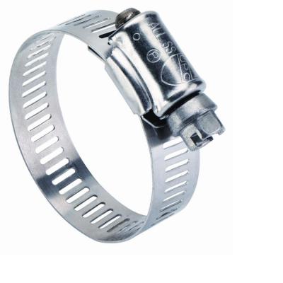

Two weeks later I was just pulling into a restaurant parking lot and the hose blew off again at the exact same place. So i walked to Walmart, got coolant and a pliers and repeated the process again. After this I suspected the clamp was just weak so I replaced it with a new stainless hose clamp and made it plenty tight.
