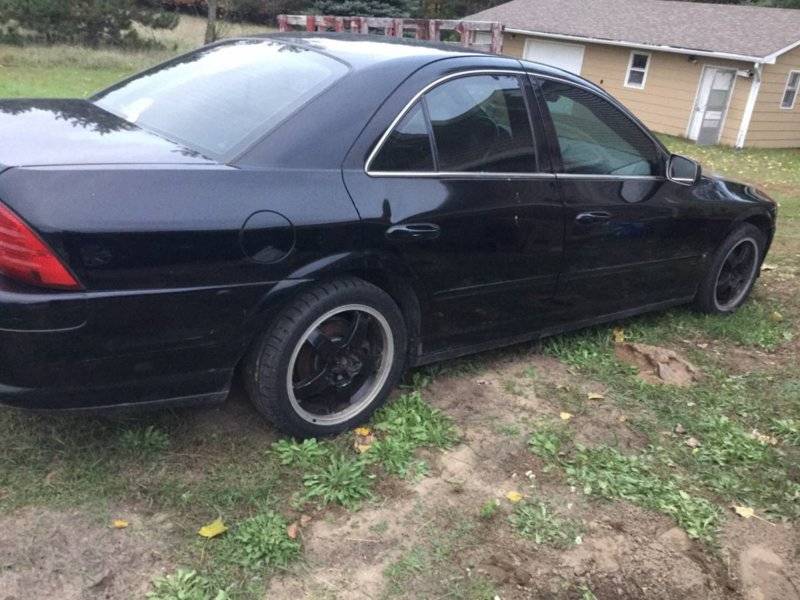

So with that being said on the Lincoln LS where would be the best place to start? Plugs and COP’s or MAF sensor? Or both right away? Just picked her up for cheap as always wqneeds new T-Stat housing De-gas bottle/Reservoir and yes the dreaded alternator...my last 2001 had the greatest engine and only threw me one code when the transmission over-Drive went to crap
