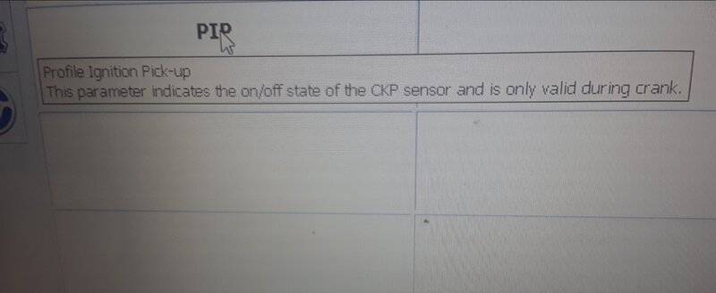

Anyhow I figured out how to bring up the PID thing in forscan to check the crankshaft position sensor, it was named " PIP " in PCM tab not sure if this is it but sounds like it. I cranked the engine for like 10 secs and it stayed at "OFF" does this rule out a bad crank posi sensor or should I check the connector?
PIP should toggle while cranking. PIP is an old term from the early days of Ford computer controlled timing advance.

Anyways I cleaned the crankshaft sensor connector , no multimeter atm. PIP Still off when cranking and added RPM PID and it doesnt do nothing what do u think

Pugged it back in and tried to crank it again but still nothing at pip and rpm

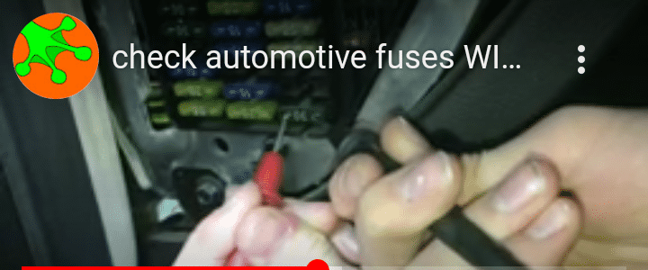

Ok so I have voltage to the engine bay fuse box at every fuses.
BUT ONLY if I put one lead on the fuse and the other lead on the body... What does this indicate?

What I cant understand rn is why dont I see voltage on the engine bay fuse box fuses unless I ground one side of the multimeter at the body? Is this a bad ground or something somewhere

You need a return path to check voltage, without grounding one side of the meter, there is no way to read the voltage. There is nothing abnormal about this. :)

...What I cant understand rn is why dont I see voltage on the engine bay fuse box fuses unless I ground one side of the multimeter at the body? Is this a bad ground or something somewhere
Apparently, you don't understand how to make voltage measurements. How else could it work? You need to get someone that knows what they are doing there to help you and show you.
What lol come one guys wtf u mean ? I always put both leads on the fuse itself and always read voltage like that..
That doesn't accomplish what you want and what we need to be able to help you.
When you do that:
If the fuse is blown and the circuit is powered and there is a load, you will read battery voltage across the fuse.
If the fuse is not blown, powered or not, and the load is small, you will read zero volts across the fuse.
If the fuse is not blown, is powered, and has a noticeable load compared to the fuse's rating, you will read a small voltage (well under one volt) that is proportional to the current flowing through it. (Actually, the voltage will be the resistance of the fuse times the current flowing in it.)
It tells you practically nothing about whether the fuse has power going to it.
