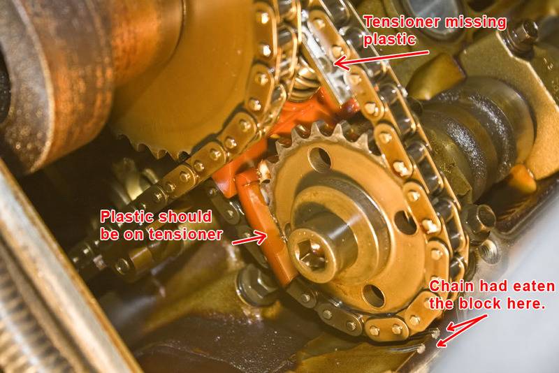

Combination of your secondary tensioner and/or timing chain slap noise.
That noise you are hearing is the timing chain chewing the inside of the engine block.
It's stretched, it has so much play in it, it rattles, clatters and runs up side the inside of the outer wall.
~ bottom right corner of pic.
If you want the problem to go away, just keep reving it hard like that!

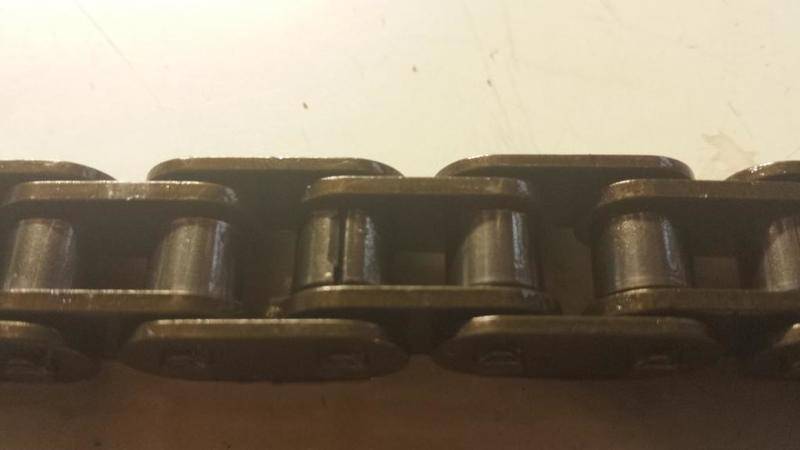

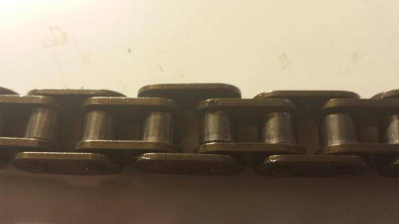

i also had to replace the chains after the tensioner didn't fully stop the rattling.
i took one of the old chains out of the 00 V8 and set it next to a new chain from Christopher's Foreign Car Parts. the difference was obvious.
here i lined them up side by side.
here is the other end. obvious difference. its not huge, but its all it takes.

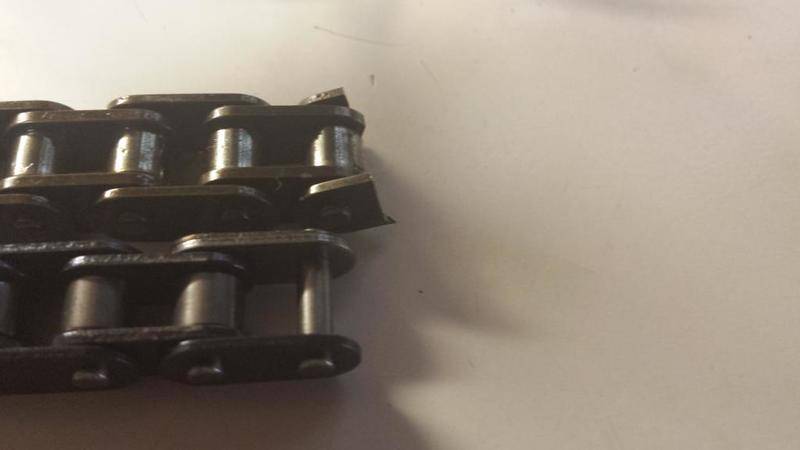

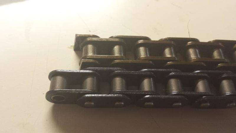

when the timing jumped on the exhaust cam, it did some damage. most notably, it split this roller.
it also stretched and damaged this link. you can see the side piece is much wider than normal, and there is a noticeable gap.
