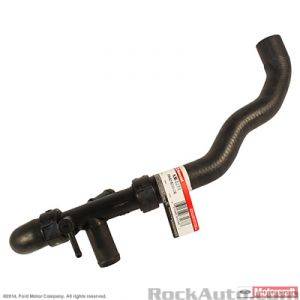

Going to do a overhaul of the cooling system hoses on this Gen 1 v-6. Ordered a Motorcraft KM 5274 as prescribed by Ford parts, Got it from Parts Geek at a decent price. But upon inspection it differs from the installed one in that the nipple coming off the plastic part at a 45 degree angle is a larger diameter than the old one (1inch vs 3/4 inch). Has anyone encountered this before? I am thinking I will have to install a bushing into the hose line to change the size to make it useable, since I can't get an explanation from Ford Parts. Anyone else encounter this?
It's possible that they mistakenly sent you a Gen 2 hose. Pic would help to determine that
I have spent hours scouring the internet looking at different brands of hoses with their specs on I.D's of their fittings. All of them have the larger size on the heater hose connection. Still waiting for feedback from two different parts suppliers on my inquiry but in the mean time I have located the necessary metal adapter fitting on Amazon for 6 bucks. As a last resort I will insert this between the upper hose fitting and the heater hose to fix this issue.

MOTORCRAFT KM5274 Radiator Upper Hose | RockAuto

So after doing more research, the answer was a new heater hose assy. P/N XW4Z-18472-DA. That solved my problem.
