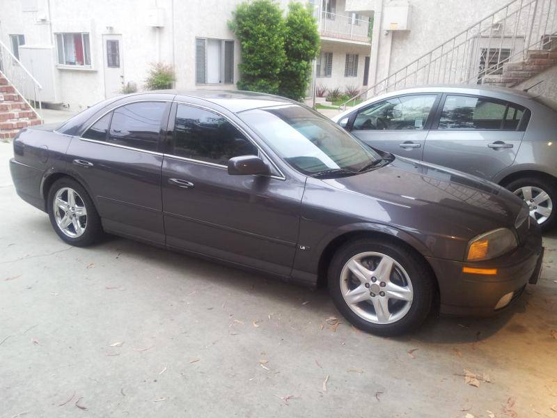

Strangest thing, my horn stopped working from the normal method of pressing the center of steering wheel. Previously when that issue started I was able to hit around the steering wheel and it will start to work again but now it doesn't work anymore at all but if I use the panic button on the key fab the horn works fine. Any information will help. #frustrated
