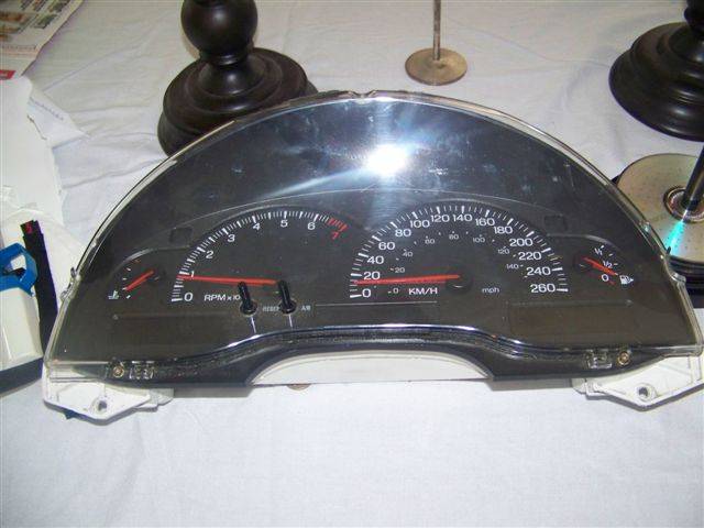

I put this 1st gen metric faceplate into an extra 03+ cluster.
I decided it was too much trouble to have the dealer marry it to my car so I'm going to put the faceplate into my original cluster.
The needles do a full sweep and reset when you reinstall a cluster so I'll keep my fingers crossed that they'll be accurate.
