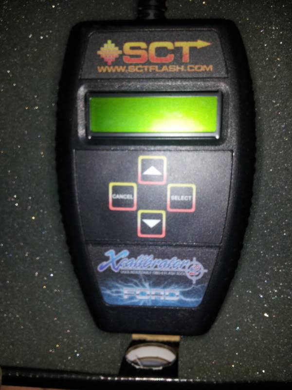

If I bought an unlocked sct handheld tuner, who could I send it off to, to get a custom tune on it? Lonnie, Dennis, John, Geno? Dallas Mustang? Gearheads? Who is highly recommended in yalls opinion? Or would they even do that? I do have a Diablo chip, tuned for a mustang though...
Lonnie. Eff that sniper chit. :rolleyes:
I sent mine to Aaron at Tru Dyno Sports in NC, outside Charlotte somewhere...very happy with mine....the other Mark site pumps up Dennis in a BIG way....i chose not to send mine there....I've heard only good reviews of Blue Oval
