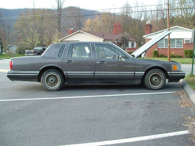

It looks good from this angle.....

If it were me -- based on what you've said and the one pic, I might just go for it.
With a TC that has 251,000+ miles on it, in my opinion, I'd buy the car... The valve seals do need to be replaced, as well as the air bags, due to air leaks. Other than that, it looks okay from the picture. As with any car though you do want to get it checked out. :cool:
