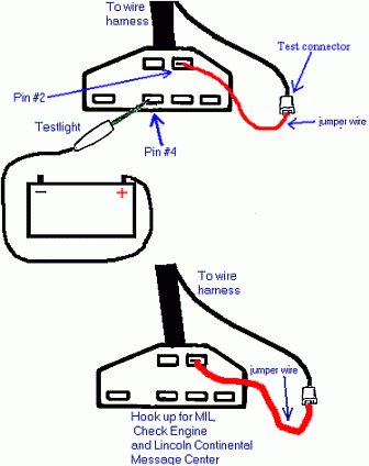

http://www.troublecodes.net/Ford/
also look here for info on pulling OBD1 codes with a jumper wire or paper clip.
since your car is equipped with a CEL, ignore the test light part.
I tried the paper clip trick and got it right the first time I got codes 17,33,25,36,63 and 21 basically my car is running to rich my engine coolant sensor is out of range throttle is too low and my EGR valve didn't open what a surprise I was right on something.
