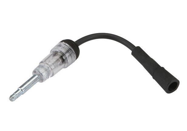

you can pick up an in-line spark plug tester to see if the spark is actually getting to the cylinder. There cheap and should be an easy test on that motor.
Looks like this...
