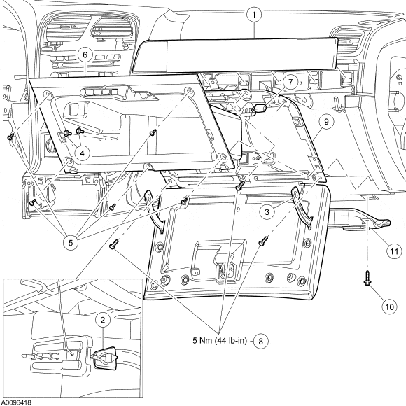

Okay friends, not finding this and what I am finding is vague at best. Instructions for removal include removing the instrument panel trim panel and then releasing the glove compartment arm assist cable from the assist arm. What is the instrument panel trim panel?

This is from memory and I just started removing screws.
There are 3 screws at the bottom of the glove box door. IIRC, i removed those and the released the "cable" and the door (I assume that's what you want to remove) came off rather easily. To get the liner out is probably much more involved.

Item Part Number Description
1 04338C Instrument panel trim panel
2 — Glove compartment arm assist cable
3 — Glove compartment assist arm (part of 06024)
4 — Glove compartment assist cable bracket screws (2 required)
5 W704734 Glove compartment screws (5 required)
6 — Glove compartment bin (part of 06024)
7 — Glove compartment lamp electrical connector (part of 14401)
8 — Glove compartment door bolts (5 required)
9 06010 Glove compartment door frame (part of 06024)
10 W704874 Floor heat duct bolt
11 18C298 Floor heat duct
