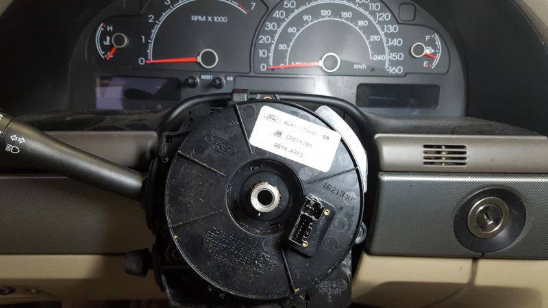

Trying to replace the turn signal switch on my '05 and finding that info on my car is rare. The threads I am finding are for the 2000-2002 models, and they changed for the 2003.
It appears the clockspring and turn signal unit are connected. I found 3 screws, 12:00, 3:00 and 8:00, and the unit is loose. But something is still holding it and it appears to be about the 11:00 position. That is the back of the turn signal switch and it doesn't have any screws going thru it. The upper left quadrant is still locked in.
Here is a pic of how far I am:
I appreciate the link Joe, that is the issue I have been running into. And the videos I found from the earlier models, they actually skip over the actual clockspring removal. Kinda strange, since that is what they named their video.
Thanks Joe. Link does work and project complete.
