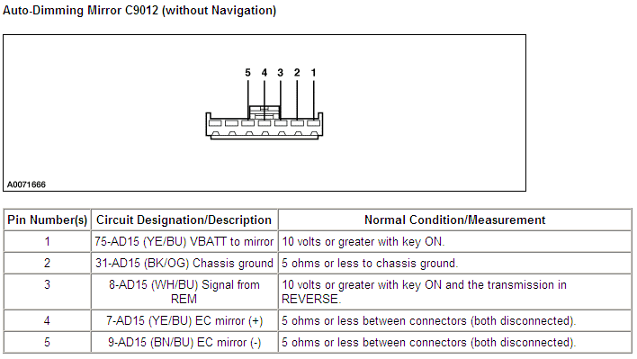

On the 01 and the 04 rear view mirror (04 must NOT have mic and nav), there is a 7 pin connector. Below is the pin-out for it:

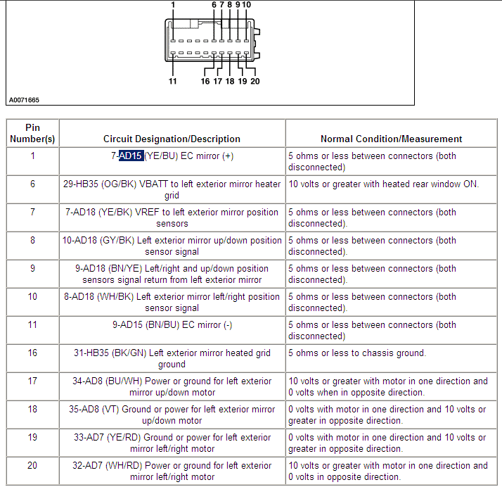

What I did was hook up 2 additional wires on the 04 mirror itself (pin 4 and 5) and ran them direct to the DS mirror. I spliced them into the side mirror at the plug. Below is the pin-out for the side mirror:
I hooked up the wires to pin 1 and 11 on the DS mirror.
As you can see, it's pretty simple. The hardest part was routing the 2 wires from the cabin to the door. I dont like wires to show, so I had to run a "snake" through the harness loom.
