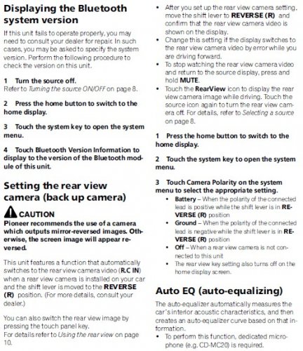

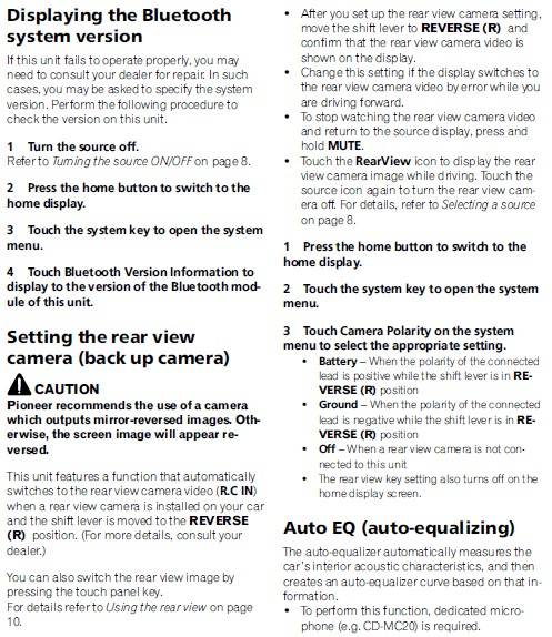

I actually just purchased the exact same one hooked it up to my flat screen in the house to test the camera before I install it on the car I removed the rear license plate surround to make sure what was behind it before I start drilling my game plane is to drill a small groove right along side the license plate bolt so I will feed the rca and power plugs threw the existing hole and just have the wire in the groove and silicone around it to keep any water out then run the wire threw the large oval shaped hole for the license plate socket on the inside of the trunk run the wire along the top of the trunk inside the liner down the right arm where there is already the existing wires down under the rear seat under the carpet and up threw the center console both rca and reverse switch wire will follow this route the pioneer at least the one I have has several different settings so ill be able to hook it up to the reverse light and it will recognize when it turns on
