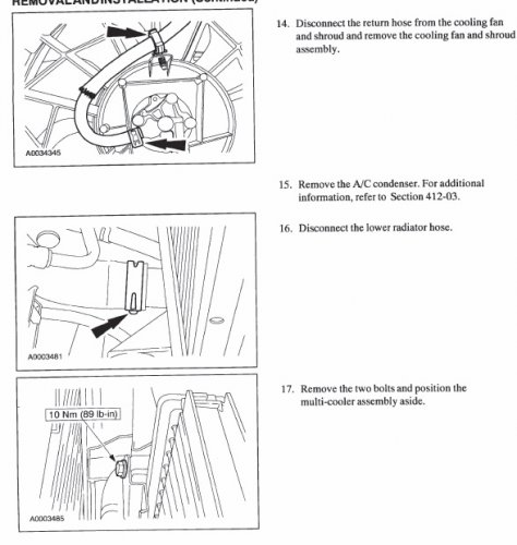

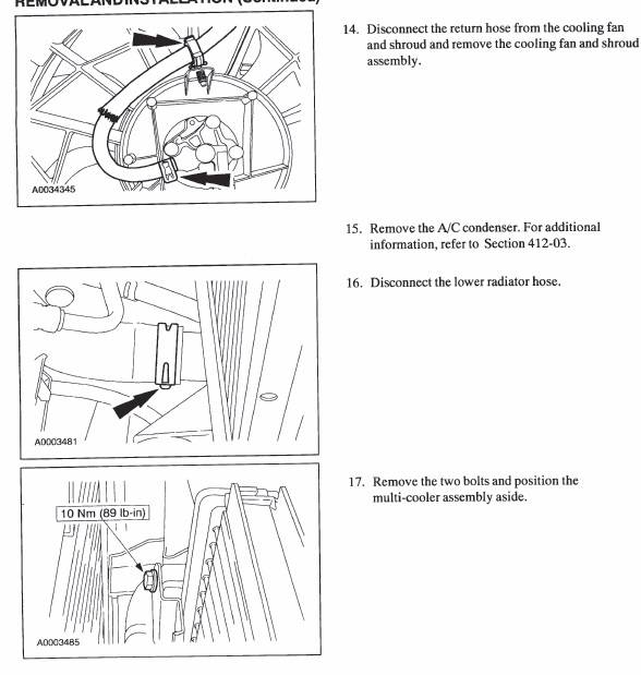

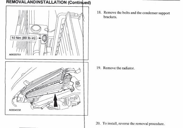

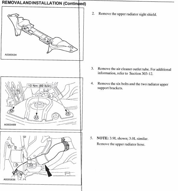

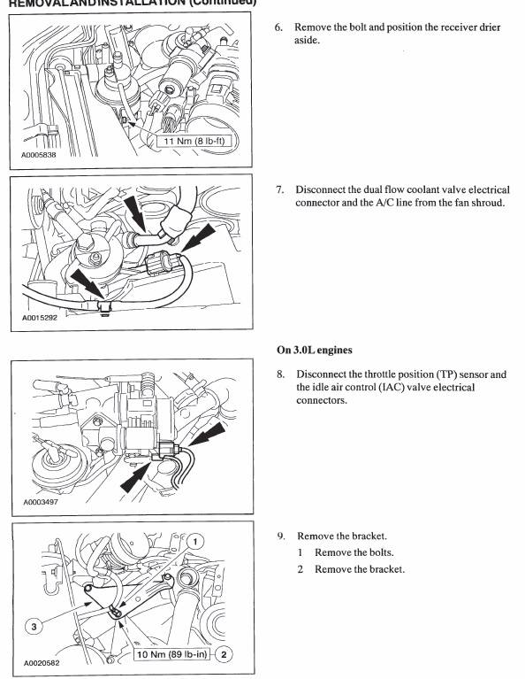

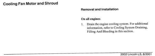

Can someone tell me about replacing the radiator in the 02 LS V8 Sport? I have a leak on the Pass side lower bottom corner. Is this common? I found nothing about I when I searched.
1. How long it takes?
2. Do you have to remove the entire front bumper?
Thanks
