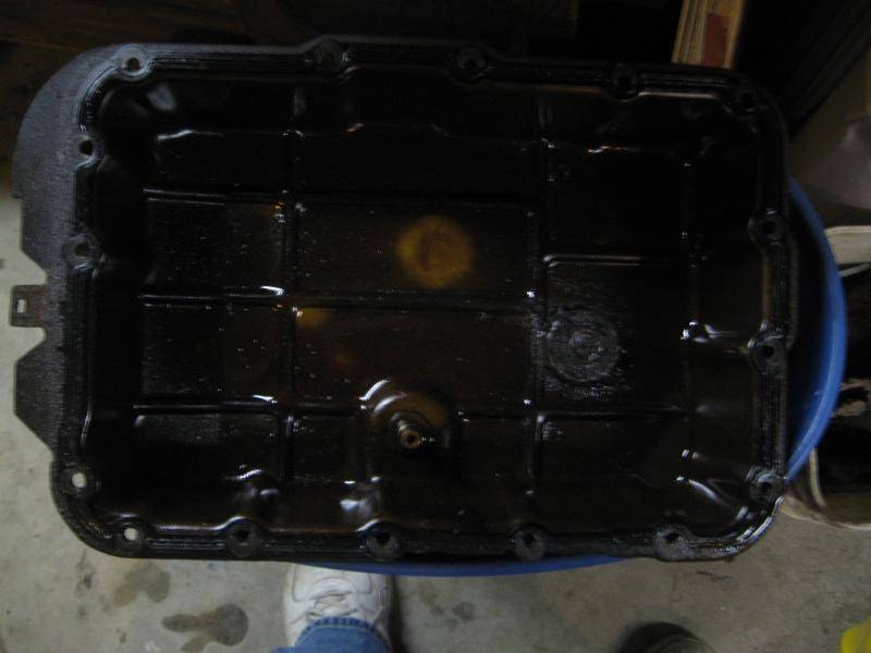

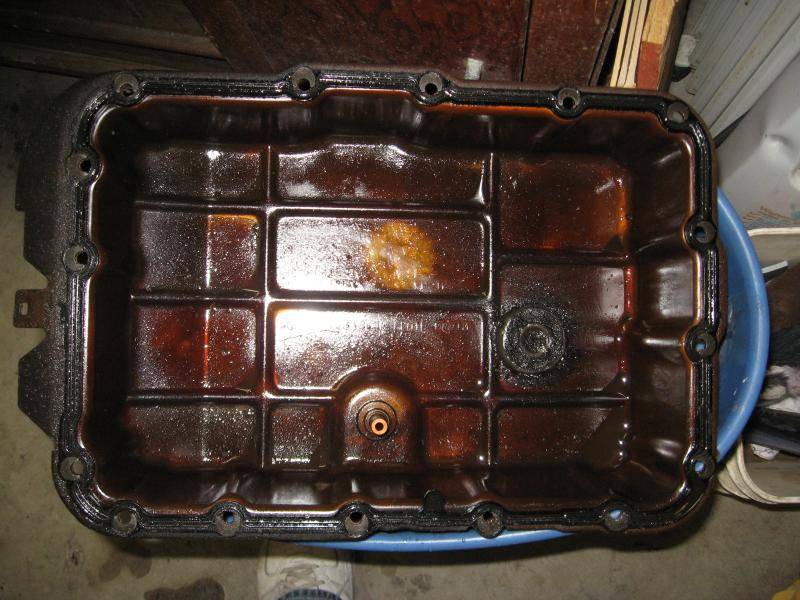

Well, got the pan off today. Fluid was an orange/brown color. Bottom of pan had some shavings on the magnet, but the rest of the pan seemed fine. Did not look anything like the photo in the 5R55 repair thread.
Was thinking of ordering a solenoid pack and see what happens. Is there something else I could be missing or any other advice?
Also, the car has 145K, 2001, and the pan had a couple of mis sized bolts, so I would assume someone has changed the fluid at least once. My son has only had it for about 15K.
Thanks again!
Here ya go. Looking at these pics, especially with the flash, sure looks worse than it did yesterday. What do you think?
I think that you need to do a full detergent flush and then fluid exchange. I'd change the filter and maybe take the valve body apart and clean/rebuild it. I think that you're already planning the change out the solenoid assembly.
