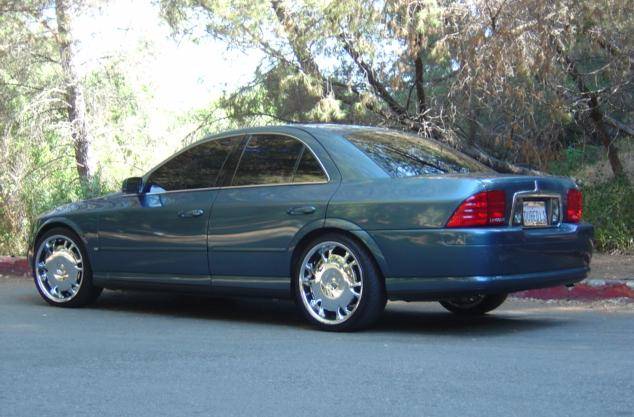

That's a nice combination man, black on black. Good luck with your new LS. I have 20" D'vinci tuscanis with 245/35/20 tires, I don't know about the all season though, I am in california.
What size would you like to go upgrade too? Or would you like to keep 17's and just get a different style?
