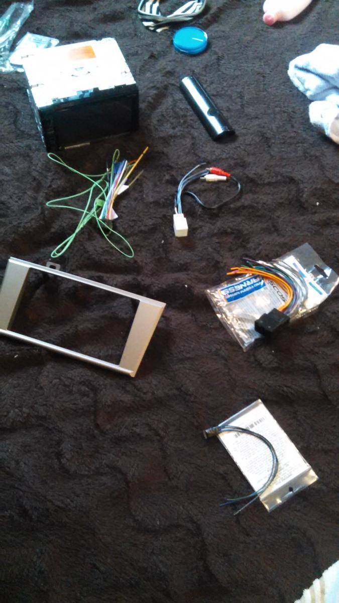

Well I got everything. About to dig in. Only thing I'm speculative in is this whole ebrake wiring bull****.
I ordered a small 3 wire bypass harness that's supposed to allow the headunit to operate dvds and all other functions that are restricted by requiring the vehicle to be stopped. But after opening up the box the headunit was in, I feel overwhelmed as hell lol.
I'm assuming this install is going to be a nightmare, and I've completely quit drinking so this will be rough.

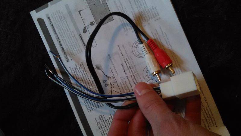

Everything seems straightforward except this small harness. It came with the headunit but the manual says nothing about it. It connects to the OEM male harness in my car but I have no idea what to wire it to. It has two RCA's coming from it, two Blue/White wires, and Two Black/White wires.
I would say search (has been covered a few times), but...
One of the RCAs is for the two center channel speakers. I wouldn't connect that.
The other RCA is for the rear subs (goes to pins 1 and 2 of the 8-pin). connect it to the subwoofer out on your headunit.
The two blue-white wires are the amp turn on signals. One is for the center channel. Don't connect that one. The other (pin 4 of the 8-pin) is for the sub amp, connect that to a 2K ohm resistor. Connect the other end of the resistor to the remote out from the headunit.
The two black-whites are to the cable shields. Connect to ground or not (debatable as to which is best).
You're stuck with the "bypass" since there is no parking brake engaged or not signal available in the gen II.

Thanks for the info on that harness.
Now I'm just curious about the parking brake bypass. The headunit manual instructs me to connect the green parking brake wire from the headunit harness to the positive wire feed of the actual parking brake. My parking brake harness has 6 wires that come from the male connector plug that connects to the electronic finger switch. Do you happen to know which one is the positive wire?
Like I said, you don't have one. You won't be able to. You'll have to connect the bypass instead.
