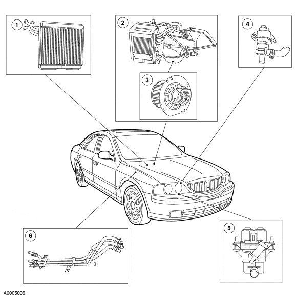

Auxiliary Coolant Flow Pump
~ The Auxiliary coolant flow pump is electrically driven and provides increased coolant flow during low engine speed operation.
~ The pump is also used to circulate coolant after the engine is turned off under certain conditions. (???)
#4 is the Auxiliary coolant flow pump P/N 18D473 (3.9L only)
Removal and Installation
  1. Disconnect the battery ground cable. For additional information, refer to Section 414-01
  2. Drain the radiator. For additional information, refer to Section 303-03
  3. Disconnect the connector
  4. Remove the two auxiliary coolant pump to fan shroud bolts
  5. Disconnect the hoses and remove the pump
  6. To install, reverse the removal procedure
    • Make sure that the heater hoses are installed in the correct position.
    • Lubricate the coolant hoses with MERPOL® meeting Ford specification ESE-M99B144-B or plain water only, if needed.
    • Check for correct hose installation by verifying DATC system operation.
Port
1 - Inlet from engine
2 - Outlet to coolant valve​
