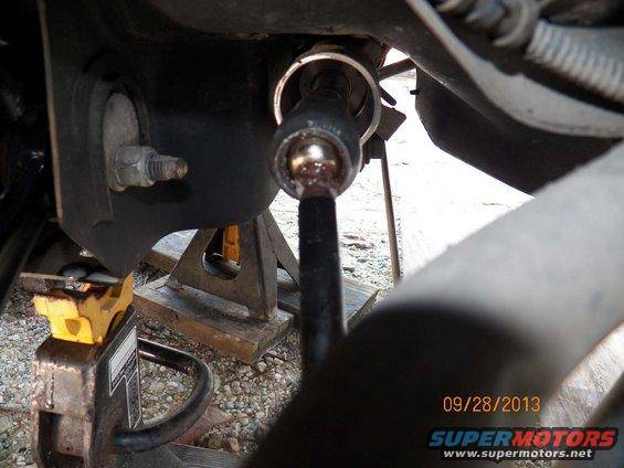

Funny you responded b/c my Mark VIII is sitting on jack stands as we speak. That vibration in the front? I think i found the issue to be an inner and outer tie rod on the passenger side. Inner was definitely bad, outer was questionable so I decided to change it anyway. The bad news? Car Quest sold me the wrong outer tie rod end. Not their fault b/c the box was labeled correctly but the design is off. It LOOKS right until one goes to screw it on the inner tie rod end. Apparently the big chains like O'Reilly, Auto Zone, Car Quest, Advance, Napa carry the inner but no outer. This afternoon going to verify in Auto Zone has the right one and get it by tomorrow. I took pictures and will show readers what I discovered.

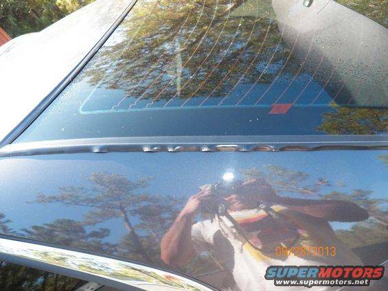

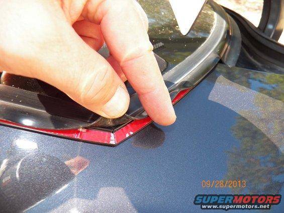

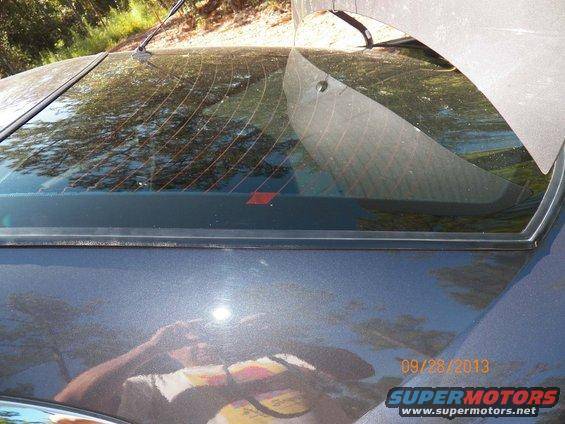

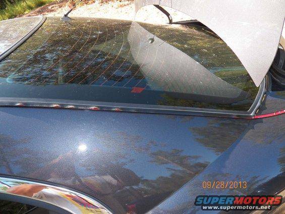

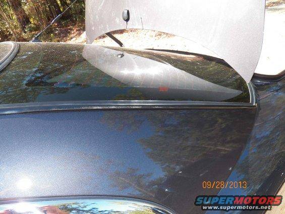

Here are some pics of what I have been up to the past few months starting with the back glass. Here is what it looked like
Pressed down, you can see it is much better but the rear window seal itself is losing its heartiness, thus the discoloration.
It worked as it should and I would use the product again. I am a member of AAA and they have a program that for $30 ($40 for non members) you can have your VIN etched into every piece of glass. Will it really deter a thief? I don't know but it may and for $30 I like every bit of security I can get.

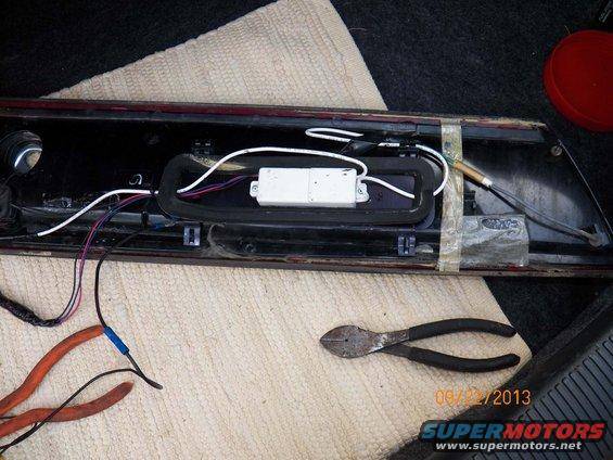

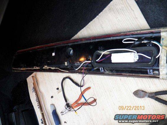

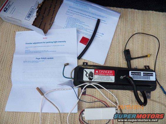

The neon was out and thanks to this forum, I figured out what was wrong in quick form. I ordered the ballast from glitch (the former Richard McCarthy) and compared to the original, it was tiny. The black one is factory, the one from glitch is white and just below the factory one.
I mounted it with rivets instead of the sticky tape that was supplied but keep in mind, you may need to grind them down so the ballast cover will fit on the back of the light correctly.

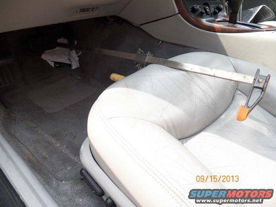

Don't have a friend to help you press the brake when testing ALL lights after an install? I use a wood clamp and put the end on the brake and adjust it so the rubber piece hits the seat. Works on just about any car you need...at least on the cars I work on.
The pic shows the neon being a little brighter than it actually is. If I went too low with the camera, it looked bright and too high with the camera, too dim. It looks good in person.

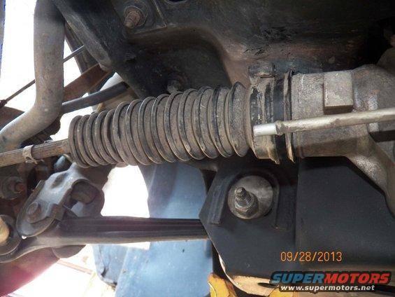

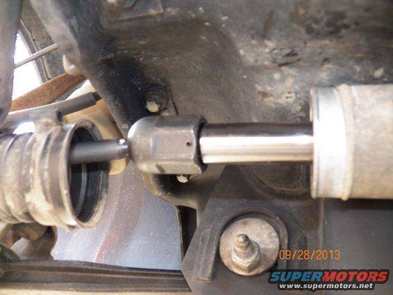

I also had a wobble b/t 60 and 70 like I mentioned above. Also, under medium to hard braking it shook the darn steering wheel. A quick move of the front wheels while off of the ground exhibited plenty of play on the right side. Turned out to be the inner tie rod end. Time to replace it. Removing the boot.
This is what I found. Semi dry grease and it was loosee goosee. Plenty of play.
While I was at it I figured I would replace the outer tie rod end b/c it was questionable. For the record, I don't like 'just replacing parts'. I'm frugal, yet have common sense so for the $20-$25 and the old one was not as fit as I would have liked, I changed it. Here are the old parts along with my trusty inner tie rod tool which is NOT NEEDED for this job. I kinda wish is was b/c I haven't used this tool in so long.
New part installed and after I find that 'clunking' sound coming from the front end that happens on occasion I will get an alignment.
