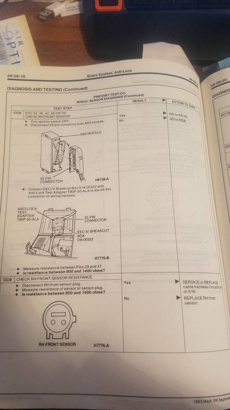

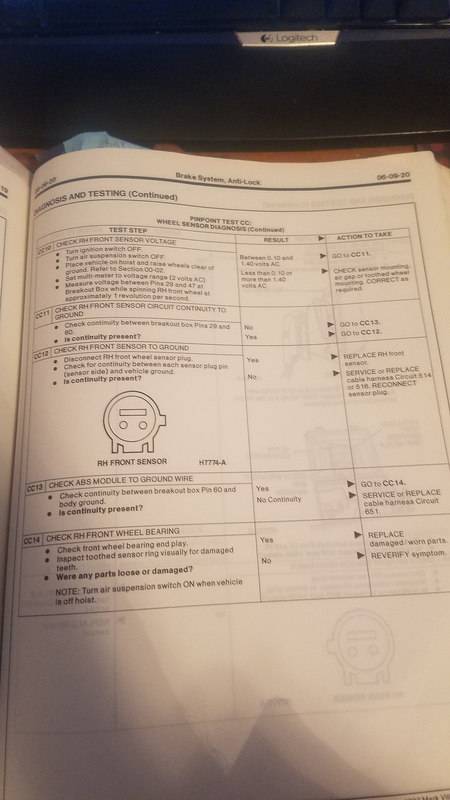

Also I was looking at the Ford wiring manual and they show a grounding splice for the shields on all the ABS wires. Is it something that can be tested? It seems like its somehow wired into the ground that gets attached to the radiator support by the battery. I can put up a pic if it would help.
If you're getting that many ABS codes I would suspect a ruptured ground or something of that nature.
here's what the book says.

Yes, The best way to check for ground is from the ABS module connector - so you will check both sensor and wiring.
First 31 & 32, then anything else like shielding.
