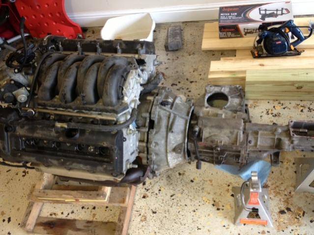

Here's my next project.
This is a mockup of the 2004 LS engine and a t5 transmission. I cut the bell off of the factory LS transmission.
It's just a start but it won't be as hard as converting to a 302 I assume.

think you'll be able to do it without one-off pieces?
The bellhousing is going to be one-off.
I have a flywheel off of a Vantage 4.3 v8 that takes a 267mm (10.5") clutch disk (1986-1998 Mustang size). These can be picked for about 300 converted to dollars. New they are about 500 dollars after shipping.
The 302 pilot bearing fits into the back of the LS crank perfectly.
Aston pressure plates are more expensive than the flywheels but I have discovered that a 4x4 Land Rover Defender pressure plate has the same dimensions for about 125 dollars.

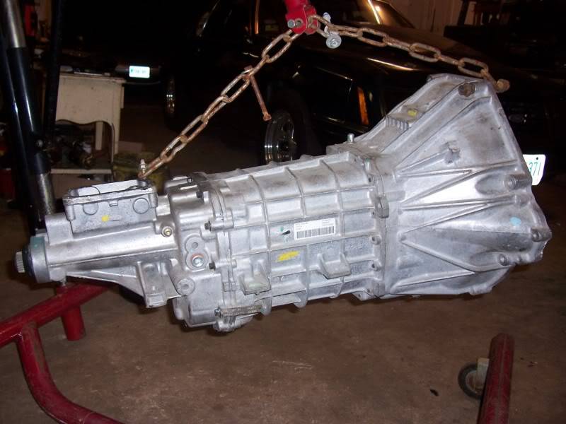

I found some Mustang transmissions that were really nice. Even a t45 out of the box can handle 400 lb-ft. I thought about this because I have a t45.
For those of you who are familiar with my 302 build you know that I am running a t5 out of a 2007 v6 Mustang. This version of the t5 has a built-in hydraulic clutch, remote mount shifter, and bolt on driveshaft flange.
The gear ratios in the Mustang v6 t5 are somewhat low from the factory and work well with the LS' weight. The sacrifice is strength. This transmission can only handle about 275lb-ft.
