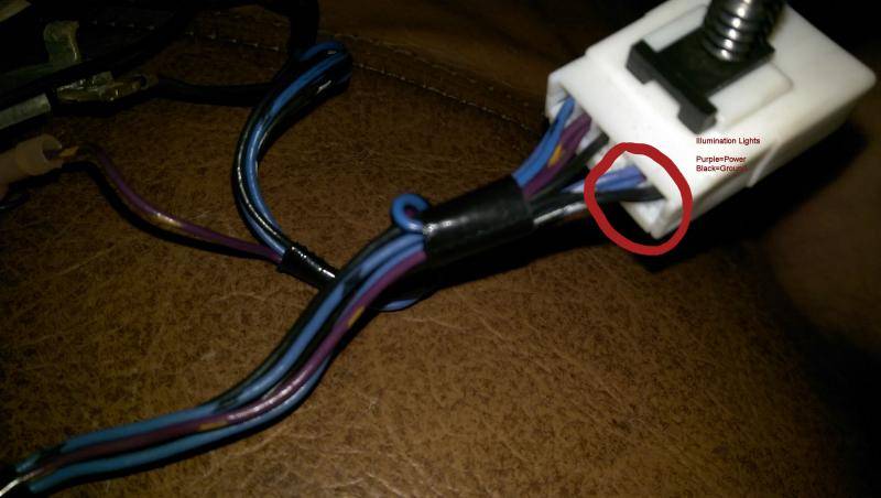

Has anybody done this before? I haven't pulled mine off in over a year, so I can't remember what I ran into last time, but I'm sitting here with my other 93 wheel I'm going to be putting in this weekend when I swap interior (again) that I want to put the 96 illuminated buttons I saved from my last swap into it.
I remember the plug was different (due to the the power and ground wires for the lights), but are all the other wires (color?) identical? If so, my thought was to just cut the harness off the controls and wire those into my stock plug which would just leave me with the two wires for the illumination function. I could wire those into the dimmer control on the instrument panel, or something of the sort, and I would be good to go.

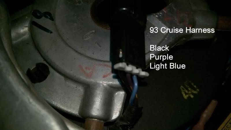

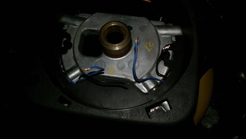

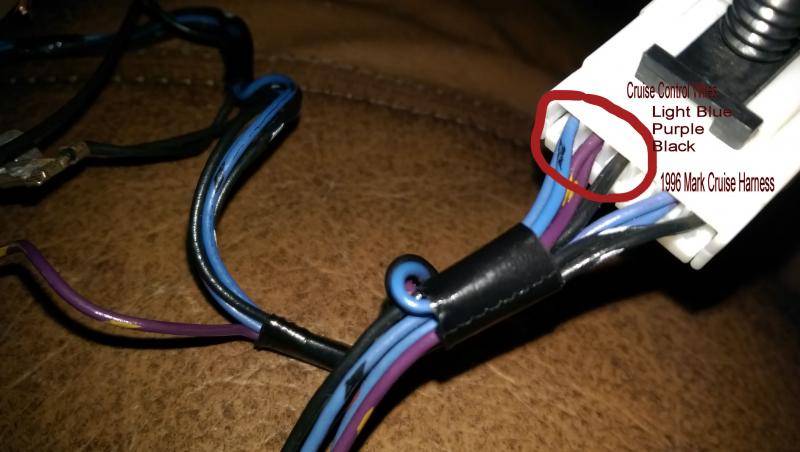

Here's my idea (which I just now tested out the harness to find the power and ground for the lights). Tell me if this makes sense....

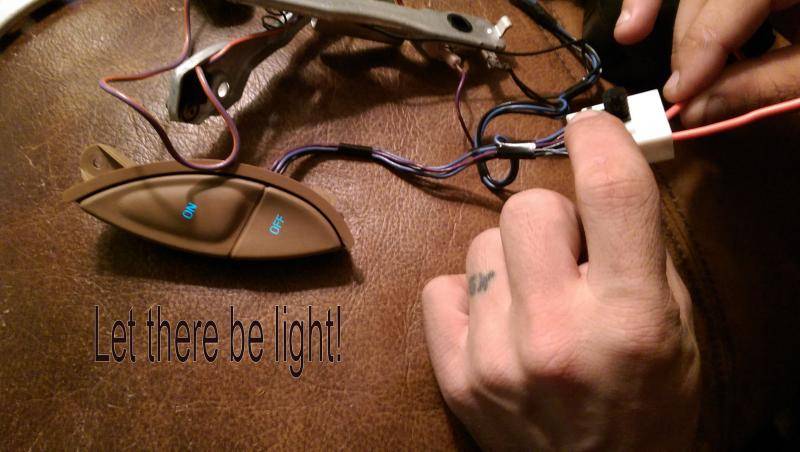

Cut the plug off of the 96. Solder the wires from the 96 (purple, light blue, black) on to the 93 harness. I'll have the left over two wires for illumination which I'll have to figure out how to run to the light switch on the far left side of the dash.

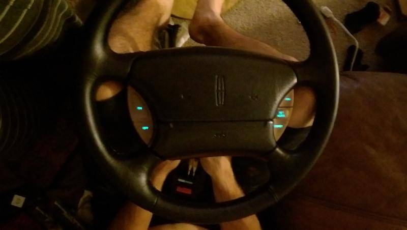

Tada!
Now if I can figure out how to run this in the car, I'll be all set.
....and hopefully all my assumptions were correct on the rest of the wiring I soldered.
