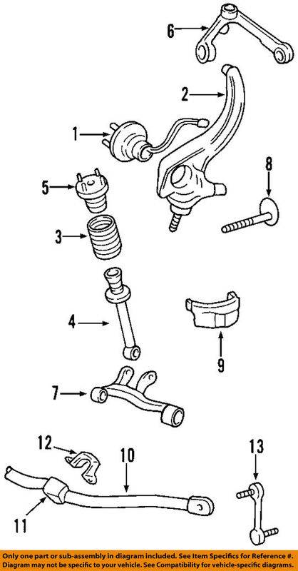

sway bar bushing. reference #11 on the below pic.
