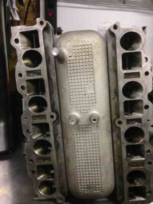

This is the intake I started with that I paid $275 for

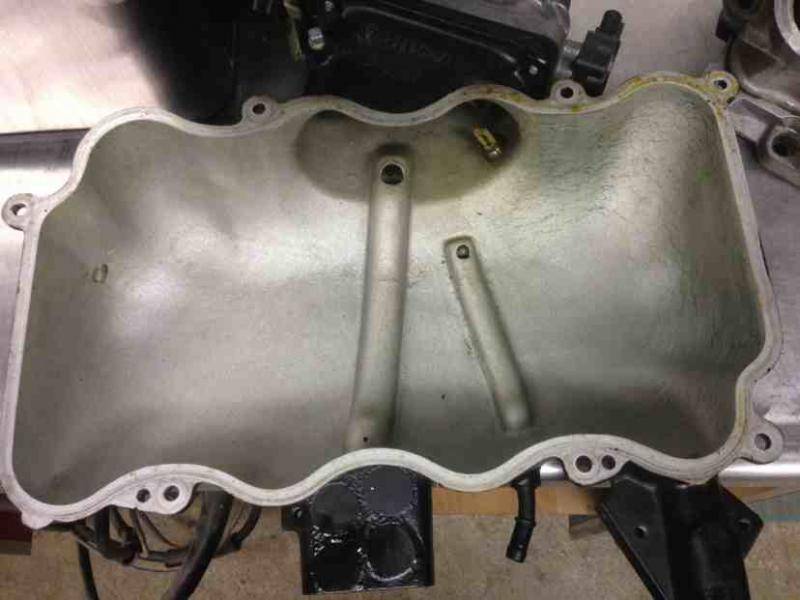

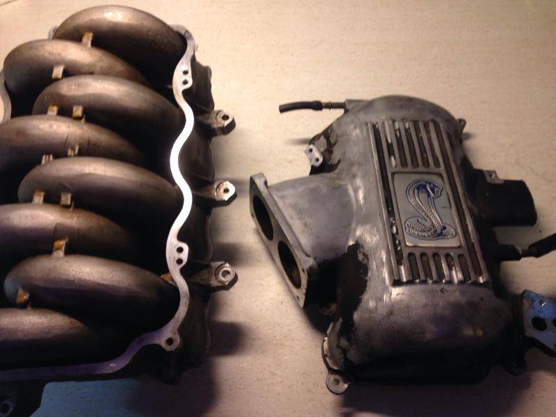

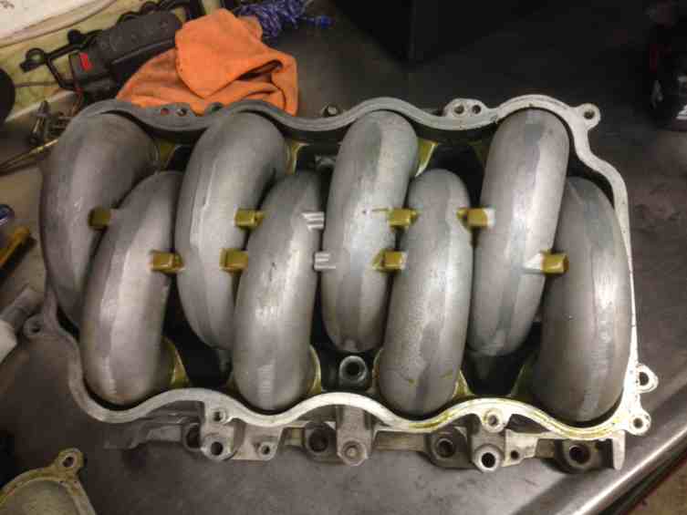

Guess what I got today... $230
Includes bolts and delete plates. The hat has been powder coated black(lost the pic). The lower is still el'natural
Looks like someone did a little porting and polishing.
