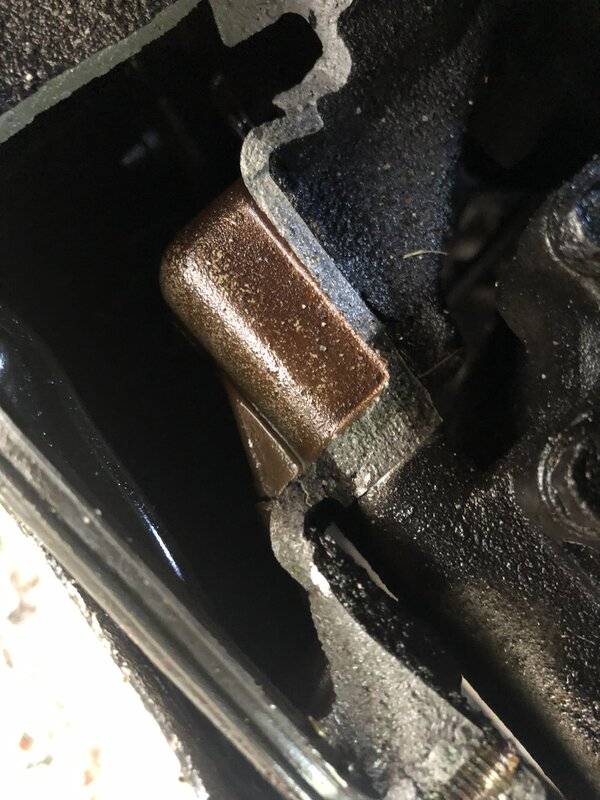

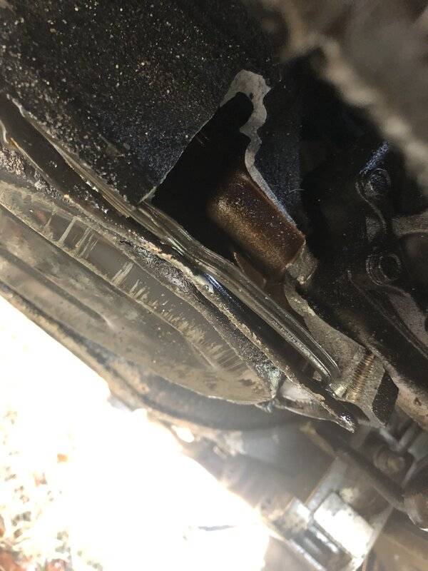

E edgarr New LVC Member Joined Dec 17, 2023 Messages 1 Reaction score 0 Location farmville Dec 17, 2023 #1 Can JB weld be used or could getting it professionally welded an option. Broken piece was never found.
04_Sport_LS Dedicated LVC Member Joined Jun 12, 2012 Messages 8,063 Reaction score 1,190 Location Somewhere around Lake Erie Dec 19, 2023 #2 JB weld will not hold up. The upper pan is aluminum, and can be tig welded... but you say you have missing pieces, so a replacement pan will be necessary. Time to go to ,(or call) a salvage yard for the upper pan. Car-part.com You can search salvage yards by location, distance, and zip code.
A ajv8 Well-Known LVC Member Joined Mar 5, 2021 Messages 204 Reaction score 129 Location Parts Unknown Dec 23, 2023 #3 yup that’s the structural sump. use ta31 or right stuff to seal that look up engine repair course 168 Last edited: Dec 23, 2023
