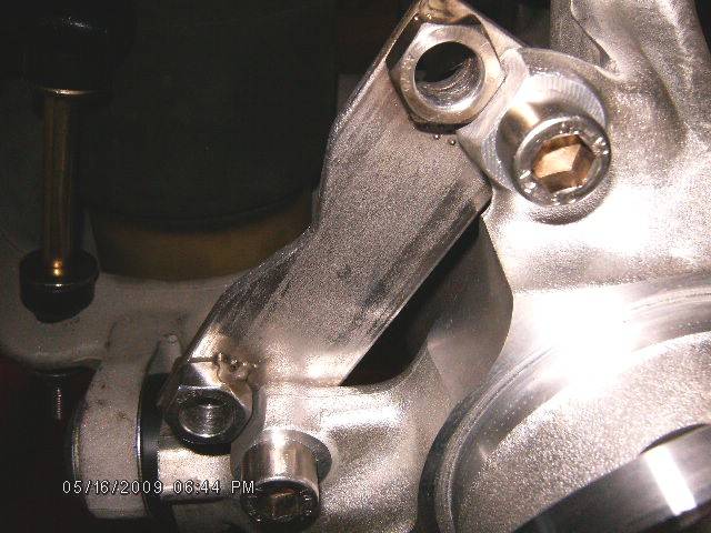

THIS article I wrote details both the hub swap and brake upgrades (yes, it's applicable to the Mark VIII). The required rear caliper relocation brackets are available HERE. The brackets pictured are a stainless steel set that I made for my '98 LSC.

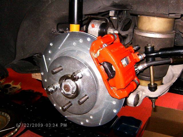

Cobra calipers and rotors are a bolt-on. You'll need at least 17" wheels.
You'll have an issue with the brake line that may require some grinding at the caliper end, or you could get SS lines.
bolt pattern wise, yes, but offset wise, no.

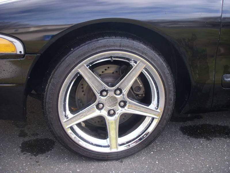

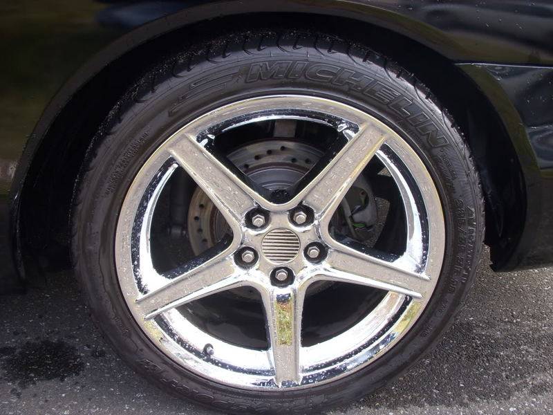

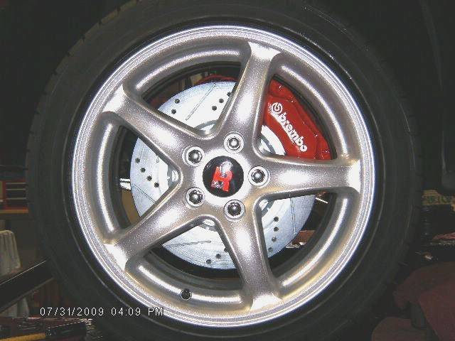

i have 13" fro. 11" rear cobra rotors, redrilled, stock mark VIII hubs with cobra front calipers, stock mark rears, and speedstars. i have the same kind of set up as DLF in the rear with a relocation bracket.
