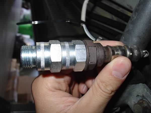

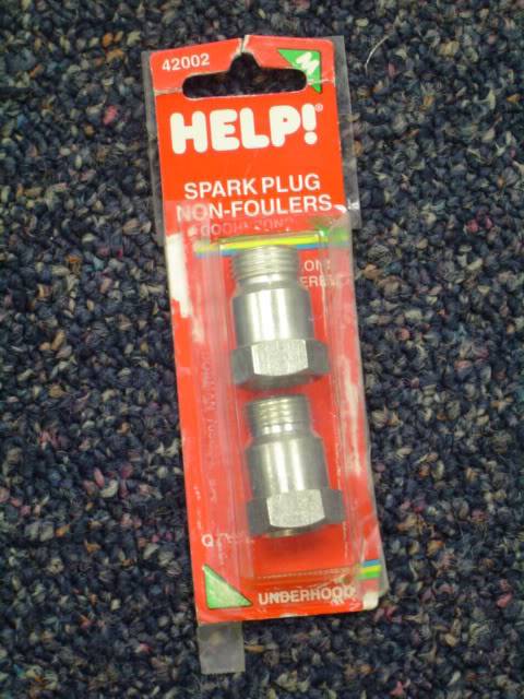

You can try the spark plug fouler method, what you do is get two spark plug fouler extensions that match the rear O2 sensor diameter. Cut the end with the small hole off on both of them, screw one into the other, install between the rear O2 sensor and the exhaust pipe. You will need two for each rear O2 sensor. If it works, fine, but it's not guaranteed to work. It's not even guaranteed that if it works on one car that it will work on a different car of the same year/make/model. I'll also add here, I have never tried this personally so I have no direct experience as to whether it works or not. I just program them out when I want to remove a cat. Actually I program them out regardless, I don't need the computer to monitor the cats.
Really, the best thing to do is just fix the COPs and plugs, then replace the cats.
yup, your right about efi live.. i was just giving the op examples of what would need to be done :)
you MAY could get someone to write a tune on sct program as well...
...and i tried those anti foulers on a kia spectra and no worky...
The only cars I've ever heard of this definitely working on is Corollas and Civics, and I don't even know if it will work on the newer ones. But, I always throw it out there for people who want to try it. If it works, it's a cheap fix. If it doesn't, you're just out 10 bucks or so assuming you plan to keep trying for a software solution if it doesn't work or you'd have to replace the cats anyway.

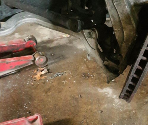

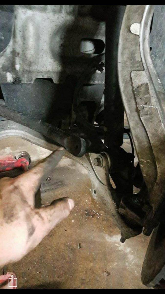

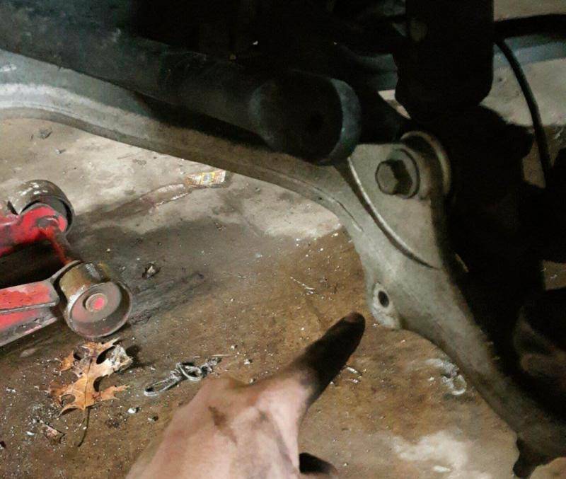

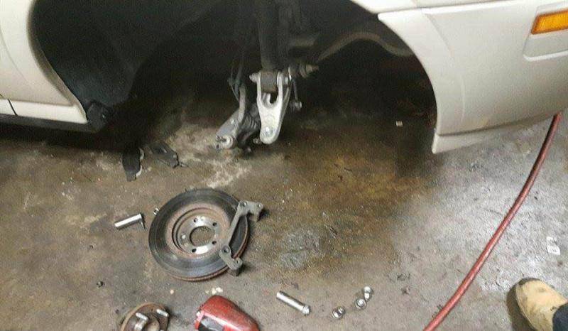

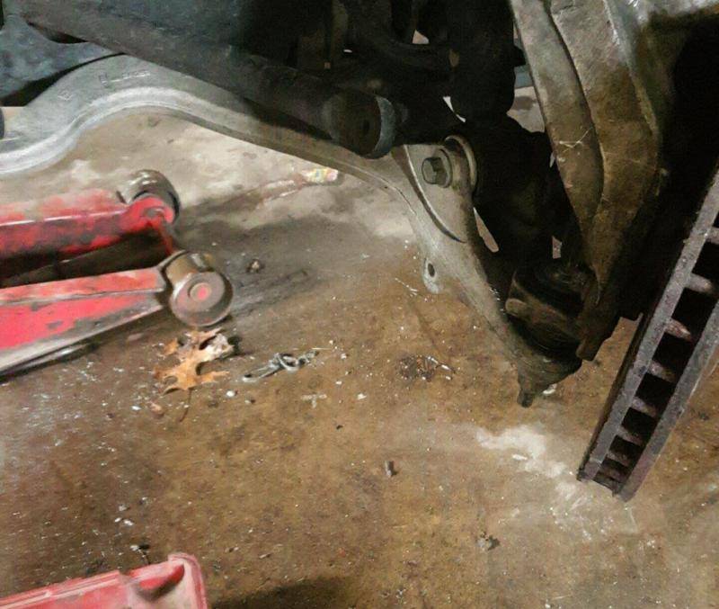

So when i bought this car i was informed of the bad ball joints so i just got them done, and the car was still flying out of control on the street. so i got the upper and lower control arms done only to find out that when they did the lower arms that they didnt connect it to the sway bar on the front right side. would this be the reason why the car was going everywhere on the road?
yes, a disconnected sway bar would cause excess "sway", but i'm not sure it would have the
car flying all over the road.
