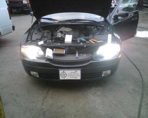

Ok, it was as easy as they say, the thing is I tried pushing em in so hard and they wouldnt go in! but the thing wasnt just pushing em in, I had to move the little pins inside the red plug, I opened em a bit but didnt work out, then I closed em in and didnt work out, and I just kept playing with them moving and moving, then from all the sudden it went in :D and I thought, what the heck did I do!!! so I did the same with the other one till it went in!
Now with the fogs it was an easier story, way easier! I didnt use those flat pins, I used and extra harness the 8000k bulbs had I donk know what for but they came handy! I just plug this harness one plug to the car's plug, n the other to the ballast red one. However, for the right side fog, I has to cut the harness and invert the cables. Im posting the pics in a little while, but I still dont know how the hell to post em here, so ur gonna have to look at em in my gallery.

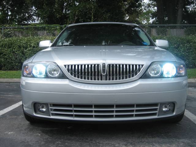

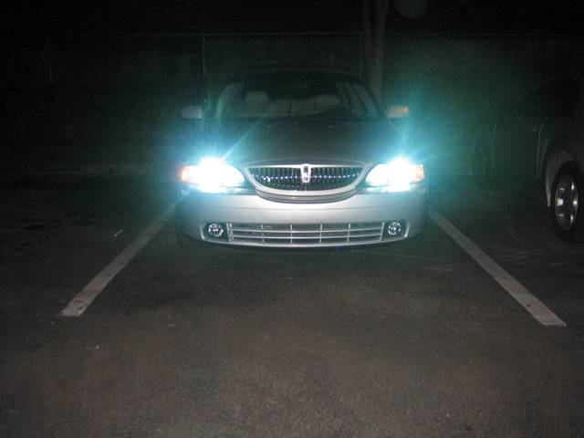

Glad to see you have it working, here is the pic from your gallery. Looks very bright and white!
