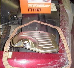

The new filter and gasket. I used the filter brand Fram Model FT1167.

- Filter Kit (Fram FT1167) which comes with a gasket which you don't need.
