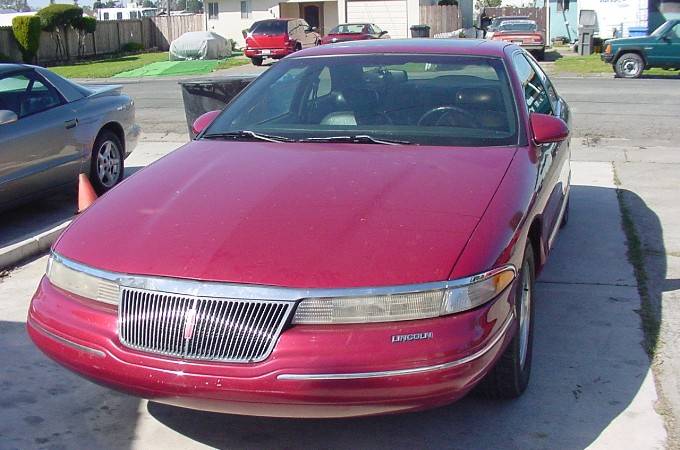

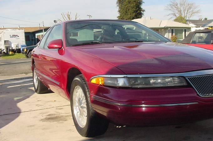

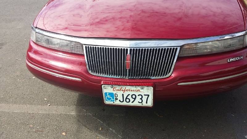

Here is the day we brought it home...I spent maybe 5 hours and 3 cans of elbow grease to make her shine for him....the first two pictures are from 2003 when he first bought it and I detailed it for him...
before detail
and here's is AFTER all the hard detail work

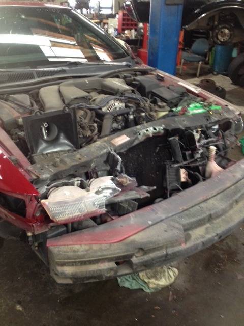

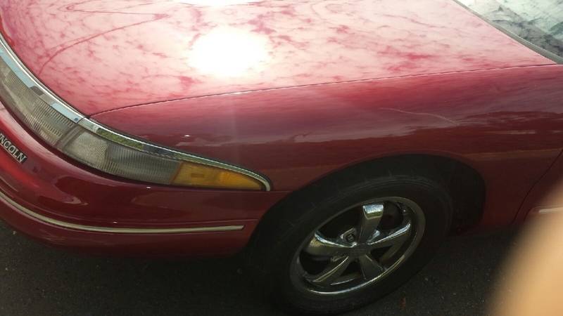

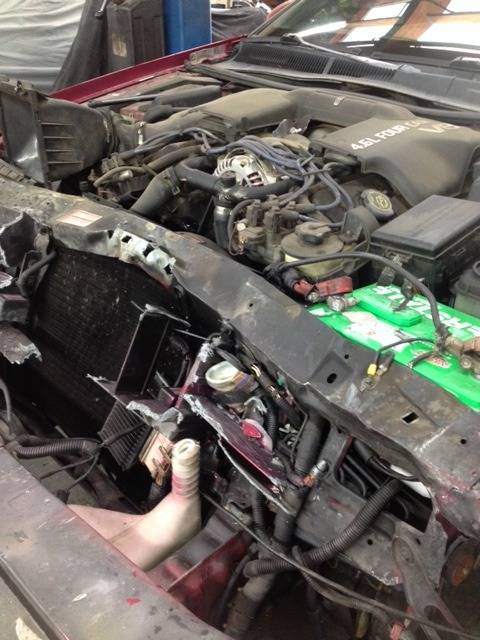

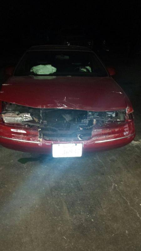

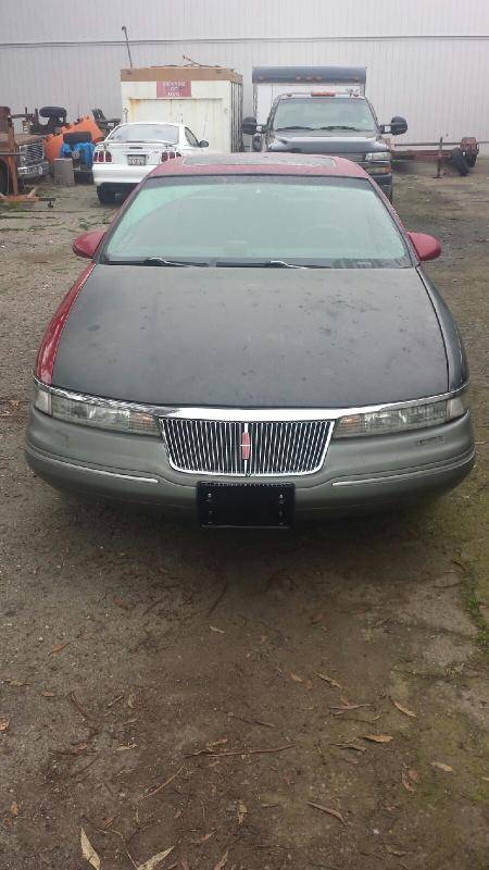

AND now, 12 years later... here she is after getting dumped off the tow truck at his shop 3 nights ago:
So he has decided since we have 3 near-complete parts cars, not to turn it in to insurance since they'll total it. Today we're going to strip it down to the core and start rebuilding it.
Radiator has a leak, power steering line is torn, and windshield washer bottle is cracked...other than that it runs and drives fine.

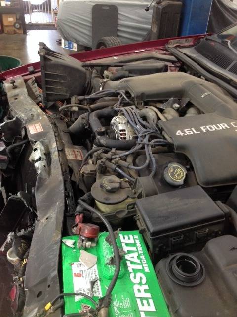

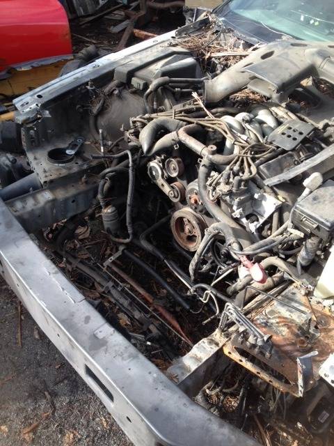

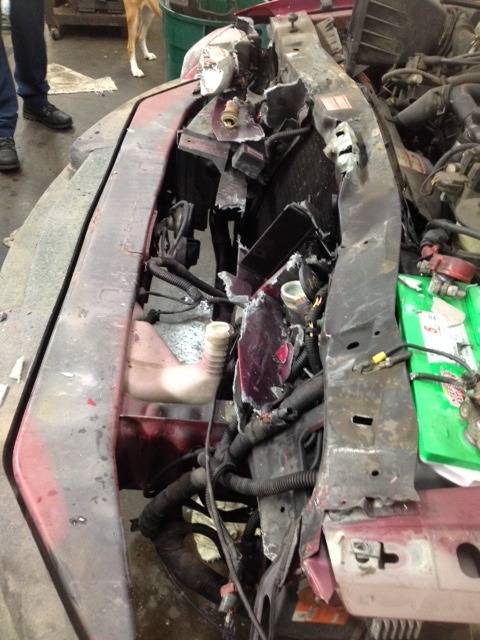

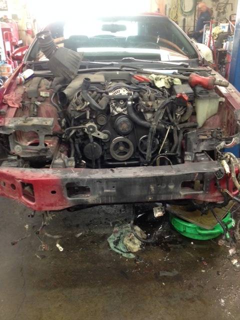

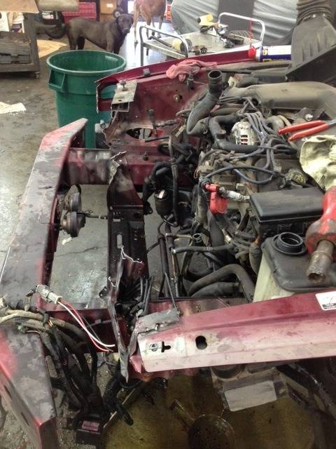

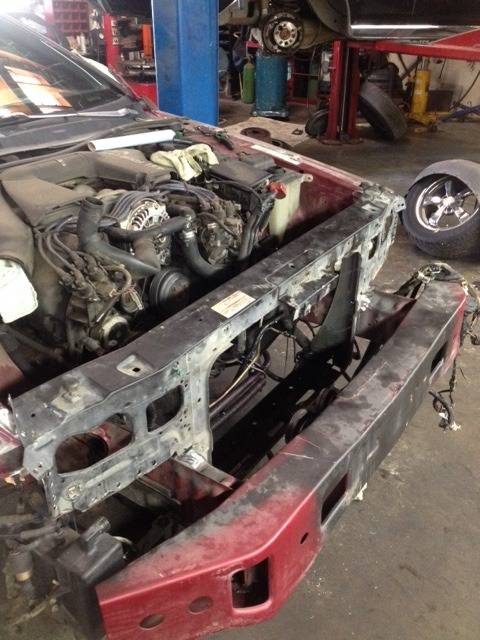

spent the day yesterday stripping broken, mangled, bent, and now-worthless parts off the wrecked front clip.
Then I browsed ebay for some parts, only to find out that as time passes pretty much everything on these cars increases in value...either that or the SELLERS think they are worth more.
I found a fiberglass header panel for $300!..that's INSANE!. It takes 5 minutes to remove one, and we have 3 in our lot...so the fun began.

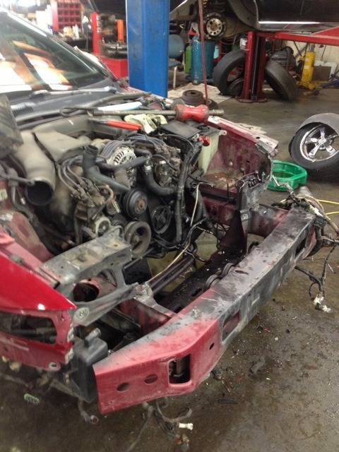

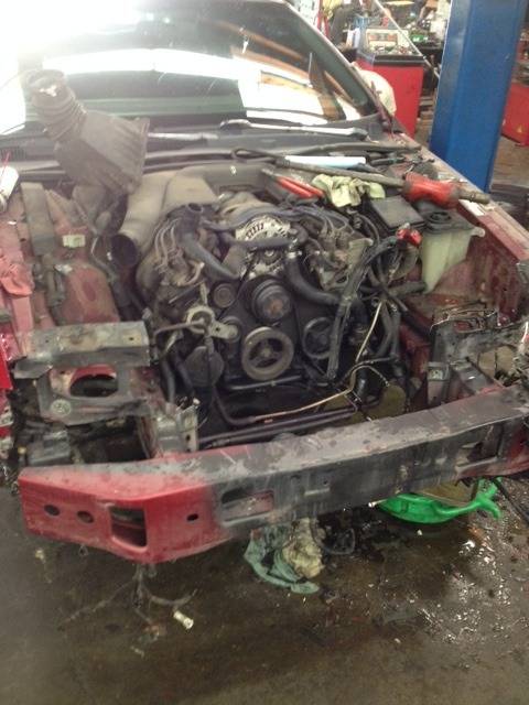

8mm, 10mm, 12mm, and clip removal tool, a saw-z-all, and a air chisel and the front core support was gone. Battery had a hole in it and the ABS controller had bent lines so fluid was everywhere...

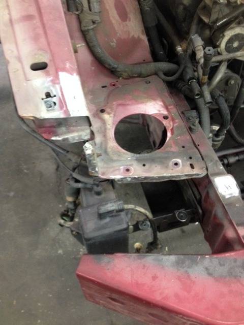

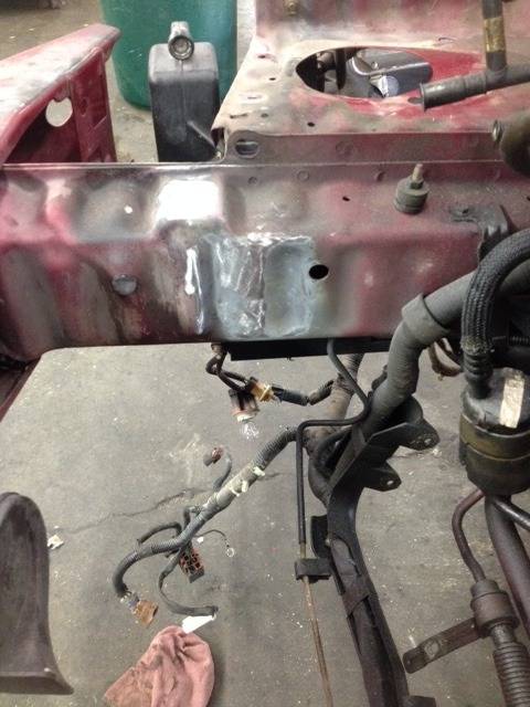

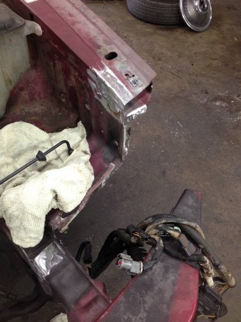

Got the grinder out and cleaned the welding spots and remnants of the old body welds down to prep for welding the header on:

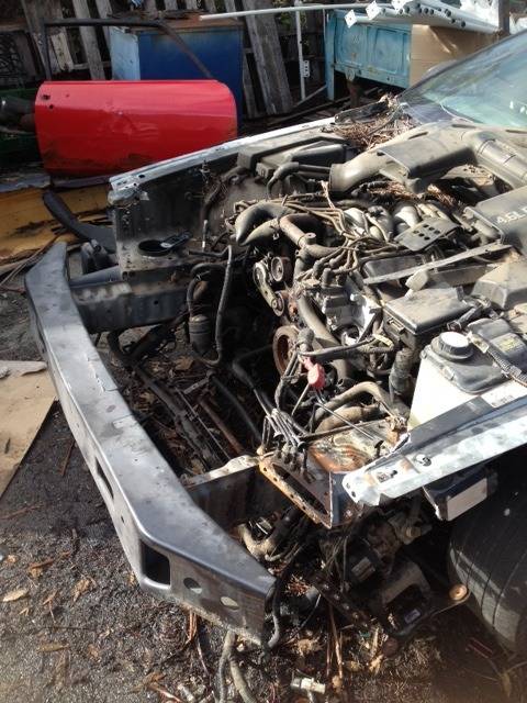

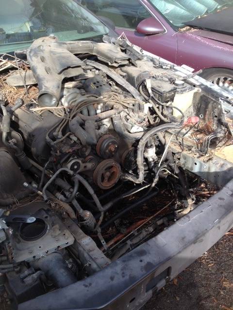

Then we carted the tools out back and played eenie-meenie-miney-mo to decide which car was the best donor. Found the 93 that already had the front bumper and fender off, still had a good radiator and condenser for the A/C and stripped the front header and core off.
You need to drill out the 40+ body welds with a 1/8" drill bit and then a weld cutting bit to free up the header so it can be removed without damage for easy welding on to the wrecked car. That took nearly and hour to do neatly.

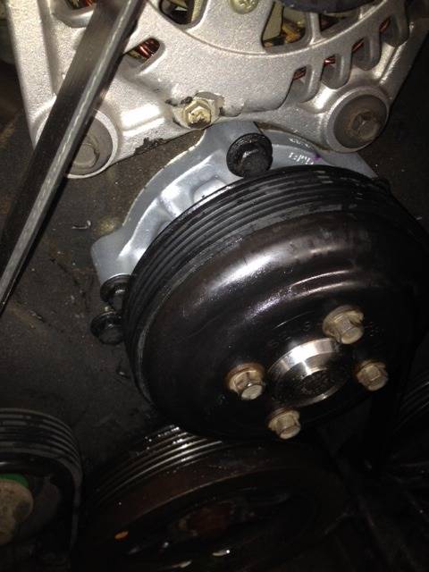

Of course, while the front clip was off I decided the water pump needed to be replaced. It's a 5 minute job when there's nothing in front of it!
The header was then set in place to make sure the frame rails and crush beams were square...it fell right in with minimal persuasion!
Just have to clean up the edges and get it welded in. Then it'll get welded in place, some body seal and paint prep.

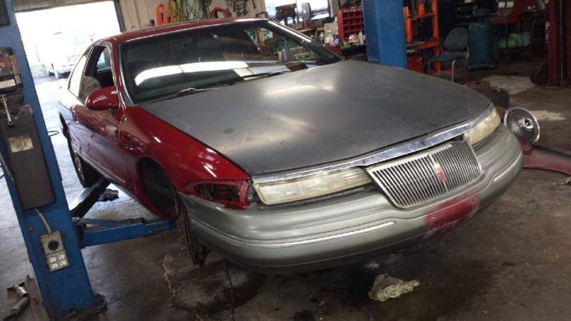

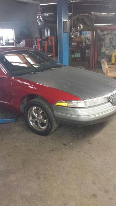

Monday the core support was welded in, the radiator/condenser, all the ABS controller lines, all electrical connections, hood and bumper were all snatched from the parts car and installed.
*the bumper is just set in place to check alignment.

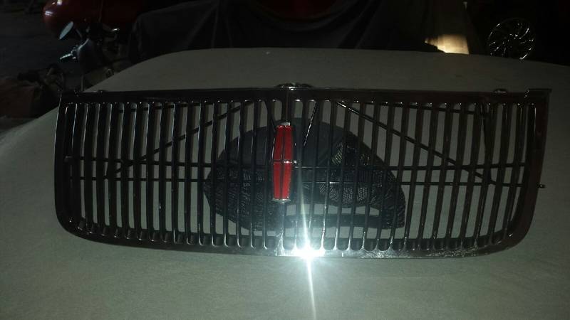

NEW grill and almost brand new headlights.

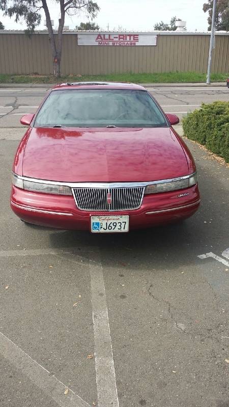

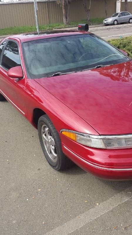

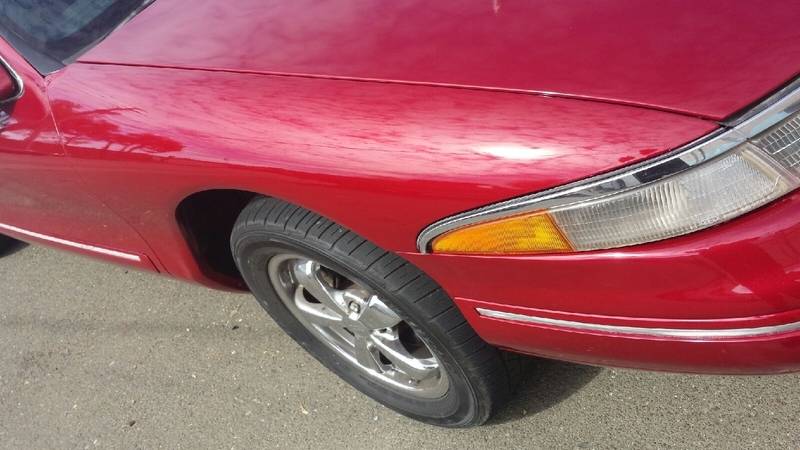

here's the new grill....and finally, the finished product. Not too shabby for a couple of ham-fisted mechanics huh?
(that's not a scratch across the left side of the hood...it's a reflection of a pole)
So, new air bags on the interior, and she is back together and drives like new...
