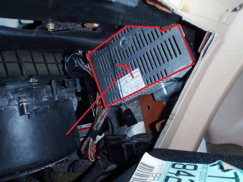

Im Not Sure What This Module Is Called But I Found A Picture Of One On The Web So If You Have One Shoot Me A Price Please. Thanks!
I ALSO MADE ANOTHER POST STATING HI TO ALL AS I AM NEW ON HERE AND WANTED TO KNOW IF THERE IS ANY WAY TO BENCH TEST AN HID BULB OFF THE CAR WITH OUT A BALLAST BUT I DONT SEE THE POST ANYWHERE SO ILL ADD IT HERE. THANKS, IF YOU HAVE INFO ON HOW TO DO THIS PLEASE SHARE! AND EMAIL ME A PRICE ON THIS MODULE IF YOU HAVE ONE.
I can get one from a parts car but it kinda looks like a pain in the arse to get out. what would you be willing to pay?
its called an SCIL module ( Steering Column Ignition Lighting ) i have several too but chris answered first, you will have to have the car reprogrammed at ford for your ignition key if you change that module.

Just a big FYI that procedure only works to program 1 key... every time you do it it blanks out all previously programmed keys...
