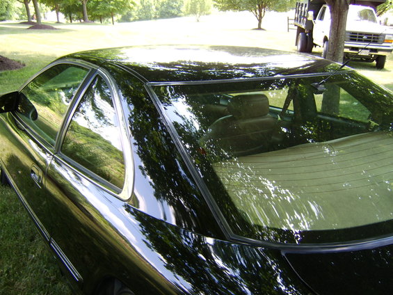

Before:
Not too bad, in fact most did not eve notice it until I pointed it out or they got closer. It looked worse than the picture depicts, though. I guess mine was in the early stages of it.

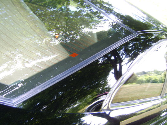

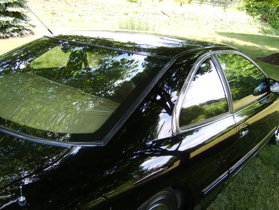

After:
closer shot:
Notice how the ends blend in to the corners pretty well.
I tested the seal today with a hose and it doesn't creat any leak issues.
