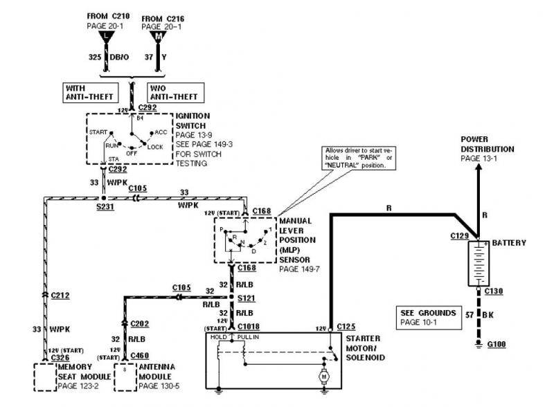

The starting system includes a lot of parts and a lot of wiring. Thus a systematic approach to troubleshooting is needed to locate where the problem lies. It's very hard to describe how I would go about it. The first thing I would do is have the battery load tested. A new battery can fail just like an old one. With test light in hand, I would start at the starting motor and work my way back toward all of the components and see where I lose voltage.
Components involved in the starting system include:
  • Battery
  • Starting motor
  • MLPS
  • Ignition Switch
  • Fuses E & P in the engine compartment fuse panel
  • Start Interrupt Relay if equipped with the anti-theft feature
  • Anti-Theft Controller Module
  • Entire wiring network
I can only offer the wiring diagrams. If you are not adept at electrical troubleshooting, I would say taking it to someone who is, should be in your immediate future.
Good luck.
Here are the road maps:
