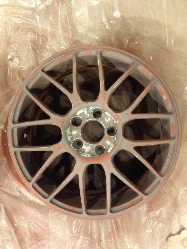

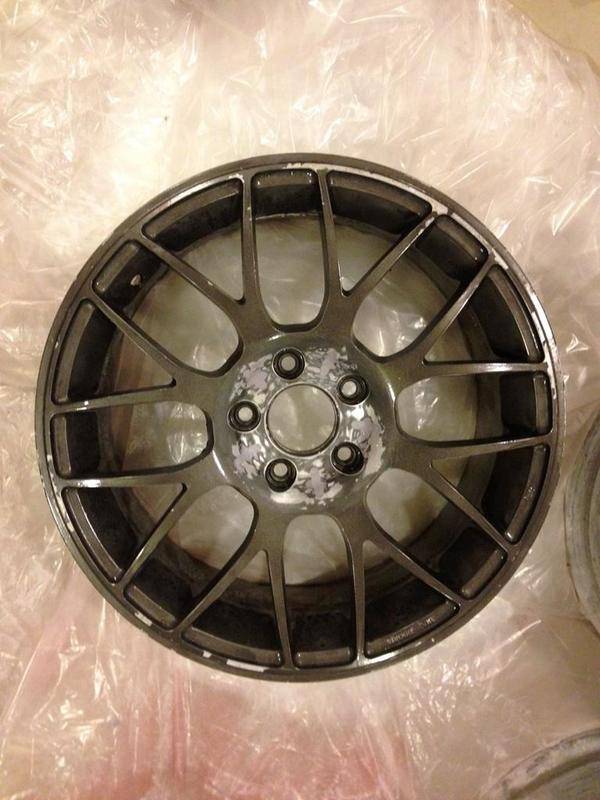

The previous owner had actually somewhat followed that thread, although I think patience/experience may have been the main difference in the outcome. Here is an idea of what I started with:

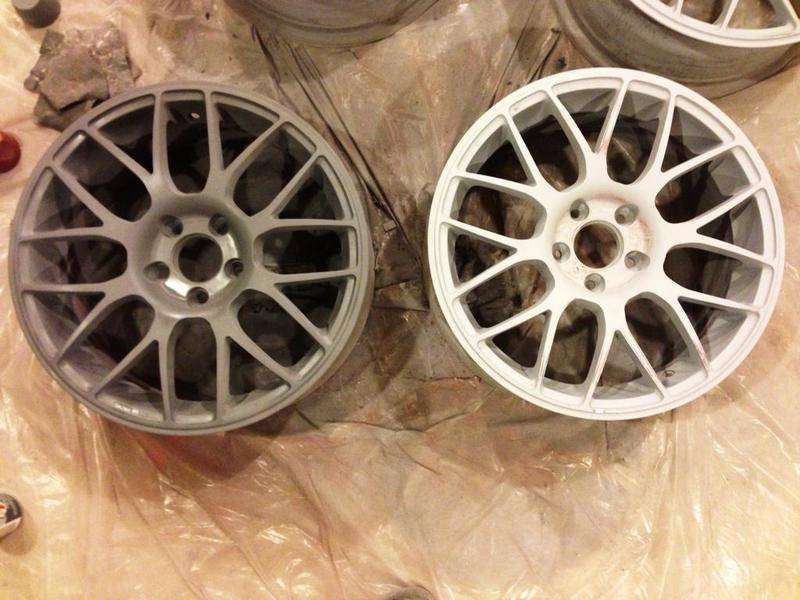

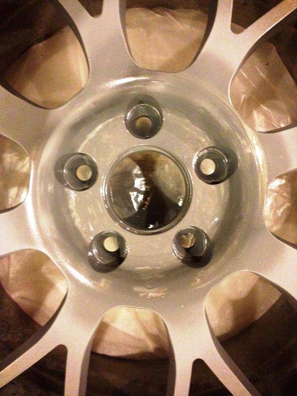

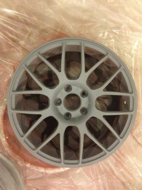

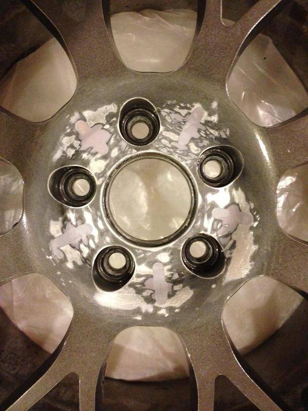

Not great pictures, but you can get some idea of the damage. I am not a fan of lots of contours on wheels, so I went to work with filling in and smoothing them out:

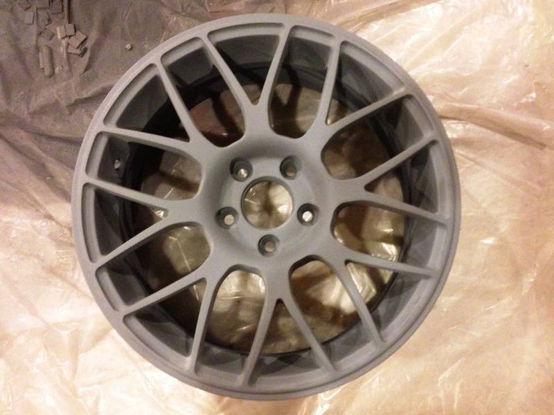

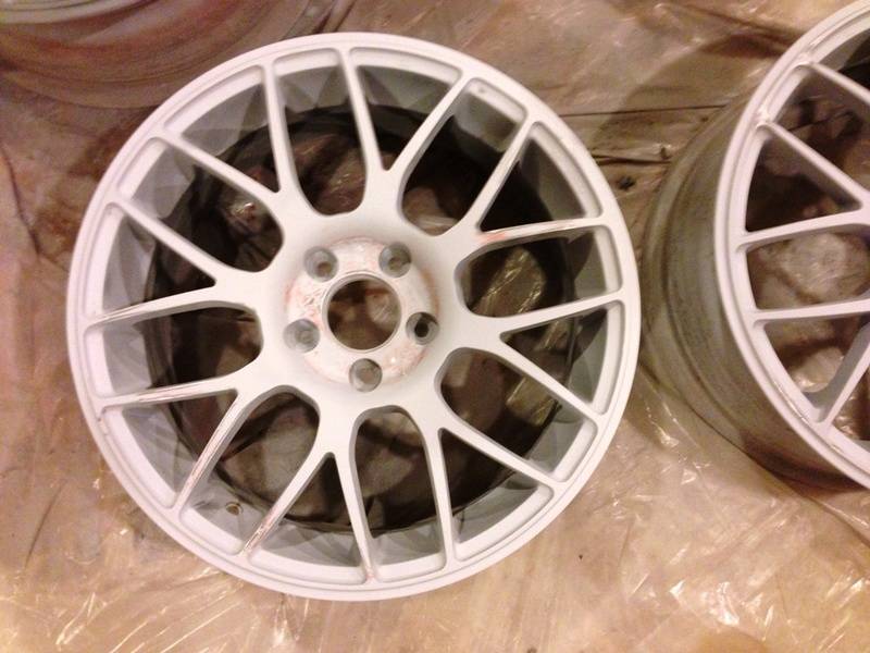

I am not great with bodywork, so I am sure that shows through. Here is the first round of filler primer:

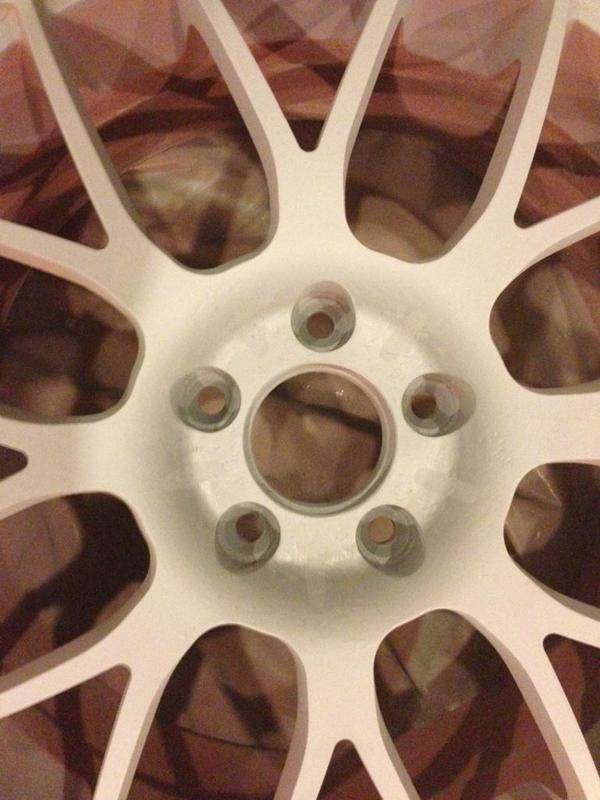

Things got better with subsequent sanding, filling, and priming:

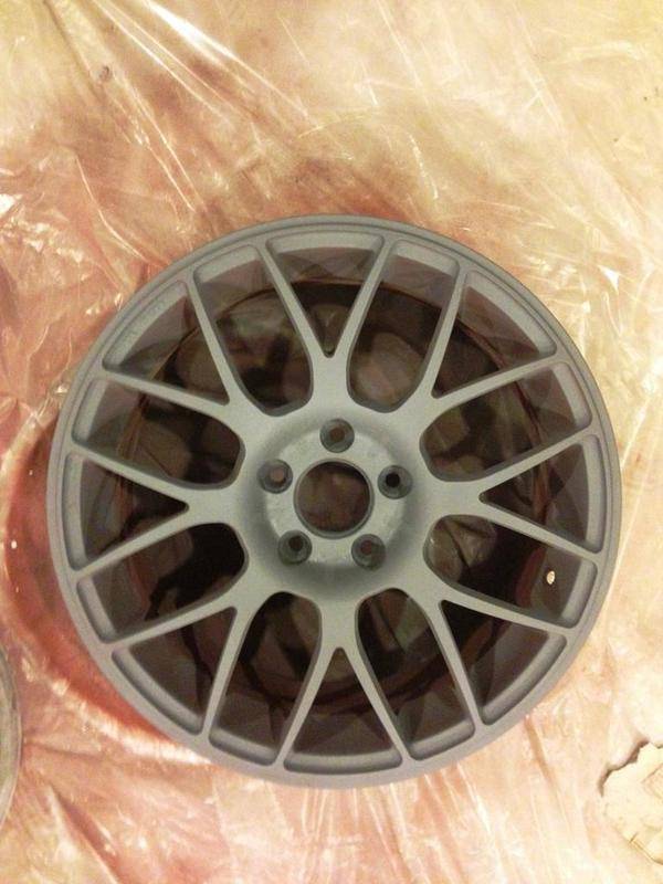

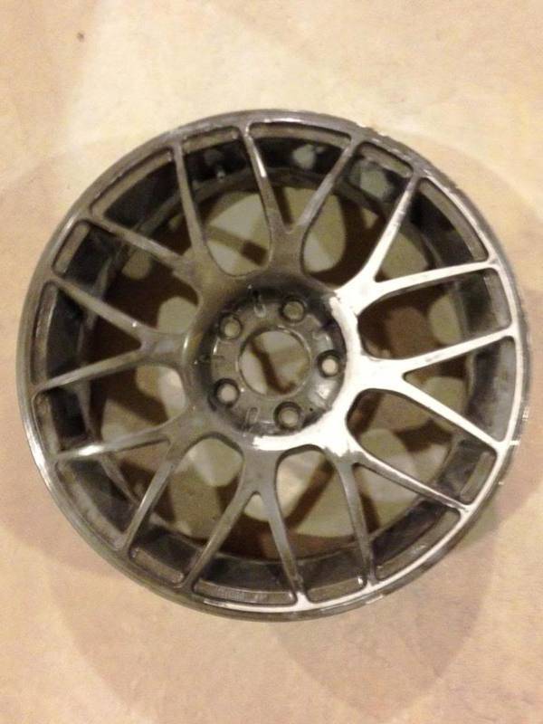

Things were smoothing out pretty well by this time, before the final round of sanding and filler primer:

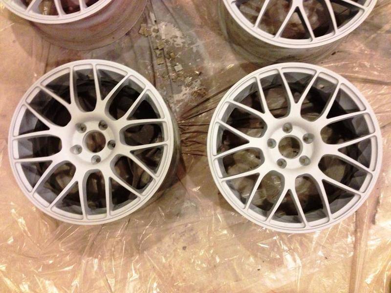

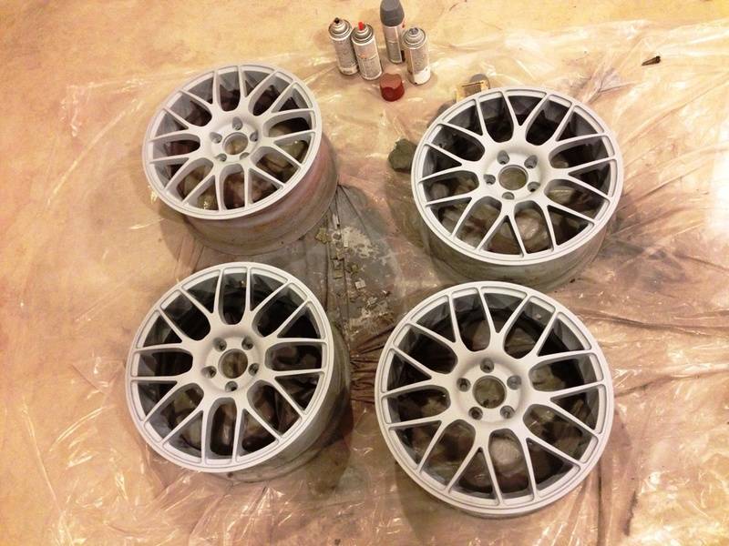

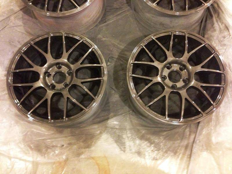

In final transition, with as much effort as I was willing to put into winter wheels before final priming and finishing:
If you look in that last picture you should be able to make out a pile of wheel weights. Whomever balanced these things last was not suited for the job; one wheel had almost ½ a pound of weights on it! That same wheel is the one with the most weight on it now, at just under 3 ounces. The other wheels were almost as bad. :rolleyes:

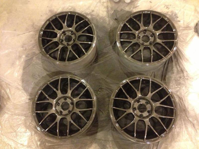

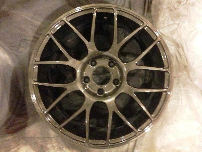

The finished product, painted and clear coated:

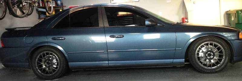

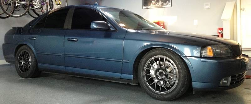

Finally, a few quick (bad) pictures of them mounted on the (dirty) car:
They look pretty decent in pictures and as long as you are a few feet away from them. I would rate them as 7-7.5 out of 10 in their current shape. They could be finished out pretty nicely with a bit more patience and talent, but I got these done in a couple days with pretty realistic expectations. I think it was a respectable transition, and the car does not look too out of place compared to the summer Ultraleggeras. :cool:
Looks good! How do you expect the finish to last with daily use? I know the repainted Tucanas I have haven't fared too well as they seem to chip rather easily. When I need tires I had planned on just getting these powder coated.
It has done just fine on the Ultraleggeras, so whenever I refinished them until now. The only issue is the occasional chip when getting tires mounted, but it is a two minute process to touch it up.
awesome winter setup...products used?
Sandpaper, Bondo, Dupli-Color filler primer and wheel paint. I used a bit of Krylon primer too to try it out, as it is cheaper and easier for me to get than Dupli-Color. It worked pretty well, although that was not filler-primer so it was of limited use in this instance.
What color paint did you use? Its hard to judge from the pics. Looks good!
Dupli-Color Charcoal wheel paint. You can use any paint and it will turn out about as good for less expense, but I like this particular color and have used it several places on the vehicle already.

Great work Josh. Are those 17s?
Powdercoating ftw.
Powdercoating ftw.
Yes, 17s. I considered getting them coated, but see no sense in the added expense for a set of cheap winter wheels, especially with as well as the Ultraleggeras have held up.
