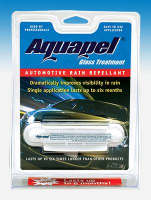

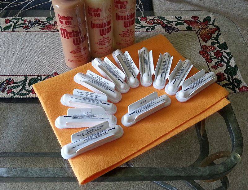

Usually I run it on Auto wipe but I find that with the Aquapel glass treatment, it barely needs or gets a wipe.
Don't even have a need for wiper blades, highway speeds in the rain, everyone with their wipers on fast, me just in the hammer lane, no wipers at all.
works wonders: http://www.aquapel.com/Aquapel-Product-List.php
Just be careful to avoid the rain sensor. Products like that (and rain-x) wreck havoc on the sensor. IIRC, it's in the OM....
It must, I did cover it, not sure the after effects, seems alright, auto wipers do work, might not come on as often but doesn't really need to with the glass treatment on.
Aquapel real good for winter ice also, have it on my beater and doesn't take much effort to remove overnight frost ice build up.
