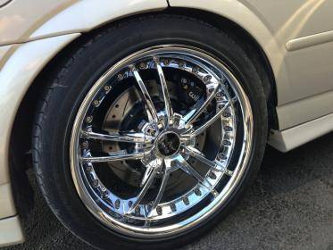

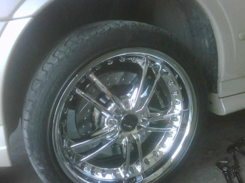

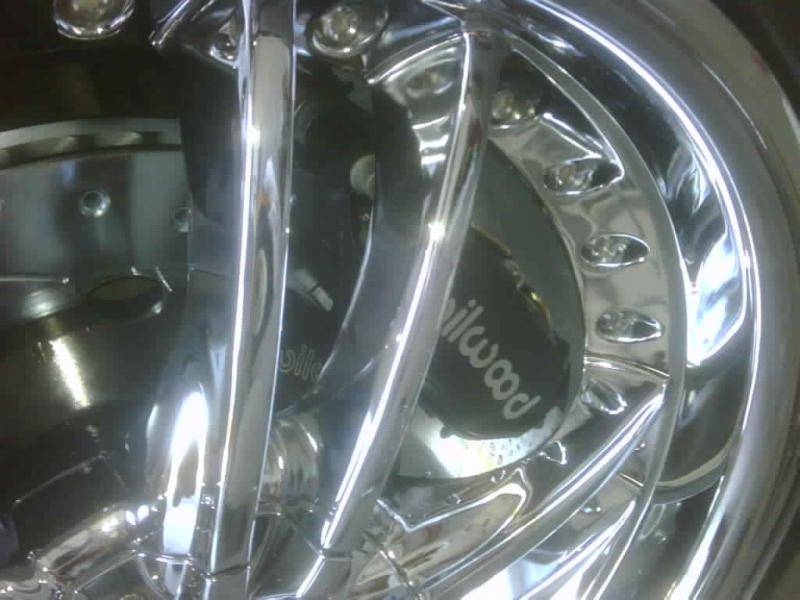

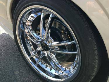

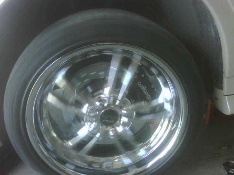

Here some pics of the Wilwood 13" rotors and 4 piston calipers Front and Back. Sorry for the 3 crappy pics they were from my old blackberry of the Ffront. The clear ones were taken with my iphone5 and are of the rear.

I did the fronts last year and the rears this year. The bracket for the rear was much easier to fabricate. But I still had to use longer wheel studs and offset my wheel .400 with a spacer . So they wouldn't run the caliper. Fronts had the same spacer and wheel studs added. You can see my custom caliper mount in the posted link above that I made for the front
