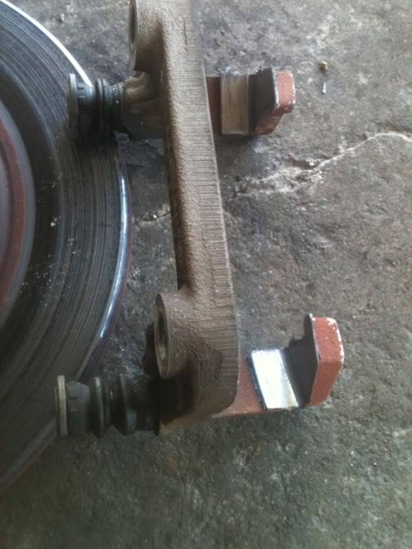

And when the axle slid out, it caused the rotor to shift, which cut the anchor
bracket.. Caliper piston over extended and dropped the inner pad
Wish I was getting paid more than $27 for this job :(

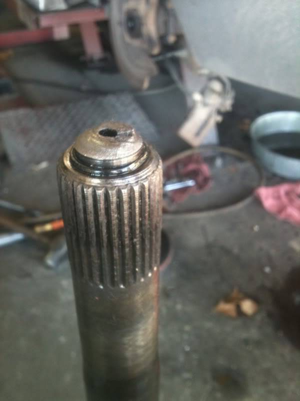

So much for that theory going around the forums that having no circlip is fine, eh?! (or did it pop out anyways?!)
What? Thats not a Mark. They are fine without the clips.
Whatever that is it has a solid axle. Looks like the rear seiezed and twisted the axle shaft in two.

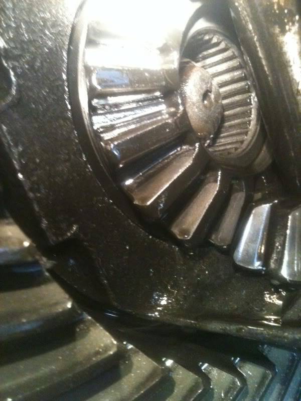

It's out of a 6-Shooter '01 Stang...you know..the woman car! The fluid was blacker than Jamies car...lol

ah, yes, true. I didn't think that out. If ours slid out a lil it'd be fine anyways for the most part due to the joints in the shaft, d'oh ;) lol... Thanks for the correction :)
I did my grandmothers Merc once before I got it and it was a super thick sludge of goo inside, no a drop close to liquid form! I don't know how it didn't make a noise!
Ours won't slide out ANY...many due to that tiny hole in the hub bearing it would have to fit through...rofl
