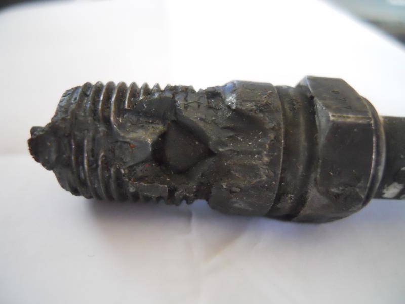

Want boost you might get this! This is in my hand as we speak.
Its the #8 so hard to see right now. The head will be coming off for sure. There is alum missing from where plug hole got zapped. I hope its JUST the head! Crossing fingers. Doing leak down test if we can. BTW this is from 2000 Lightning 12 psi.
The the threads are pointing up it looks like something tried to get out rather than the plug ejecting.
Yes it burnt a fire slot right out side of plug to atmosphere. We thought he did the normal plug blow out because it was pumping out air. Plug was still in head. Its a Ship show now. I just shipped my pants.
