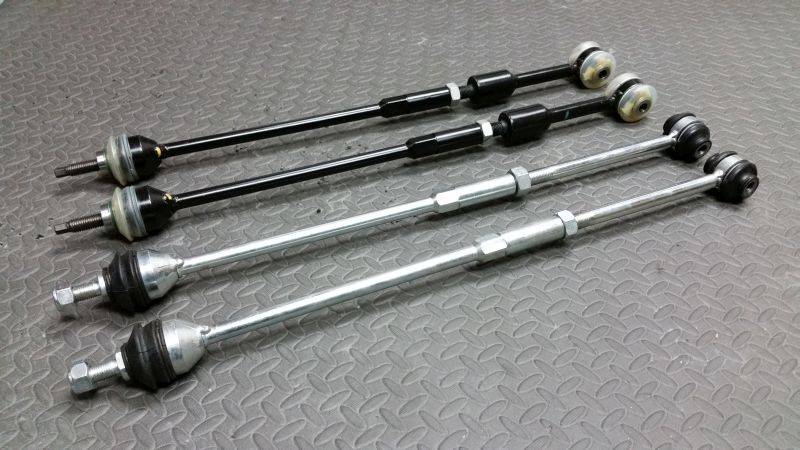

Allow me to elaborate,
As Joe already mentioned there is a dampener in the middle of the Motorcraft OEM rear Toe Adjust Linkages.
see pic,
See the black OEM linkages? See the bulged portion near the end, right after the jam nut ?
Compared to the RimmerBro UK Jaguar aftermarket, the silver non-painted linkages? It has none, just a straight shaft.
On the OEM's that portion is a dampener, spring loaded I suppose, it's called "Rear Passive Steer".
It allowed for the rear toe adjust to flex a bit during turns, basically the rear wheels are allowed to follow the car around turns.
It's ever so small, you'll never notice it, I bet it's less then a half an inch if that.
On the Deeza's or the RimmerBro UK Jaguar aftermarket rear toe adjust linkages, there is no dampener and thus is a solid rear toe alignment.
Some prefer with rear Passive Steer, some don't care for it and some like myself, just think it's not enough race car and they are cheaper.
Works all the same ... if anything it makes the rear end feel more tight and kicks it straight around the turns.

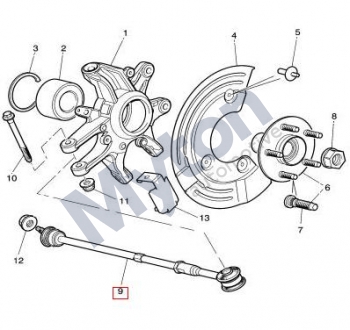

How will rearsteer be affected that much by just the tierods its solidly in place? ...
Whoops ... Ok, because these passive or non-passive rear steer toe adjust linkages connect to the wheel knuckle, without being connected, your rear wheels would fling side to side.
make sense?
you should find a pic of the rear suspension or crawl underneath and have a look.
