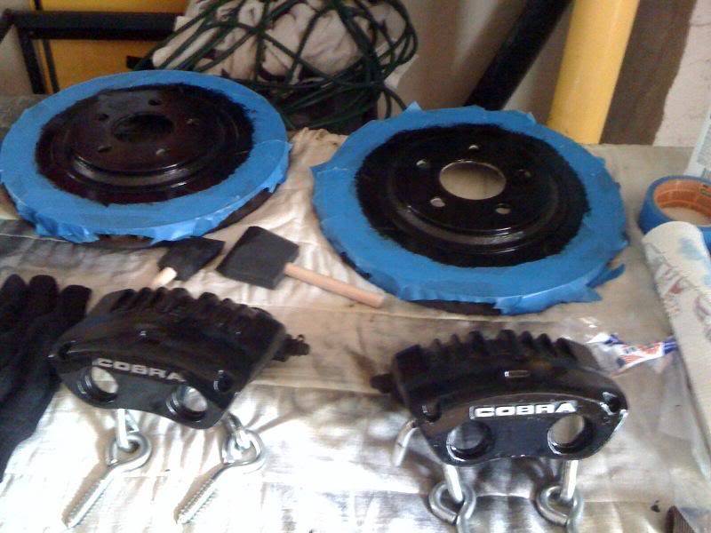

I agree you don't have to spend top dollar but you also want a quality product that isn't going to fracture over time, especially when we're talking about the parts that stop the car; def don't want them failing. If you don't want to spend the cash then just get the factory rotors cut (if they're still good) and buy quality pads, in my opinion. If you're worried about the look with rust then use caliper paint and paint the center hats / "outer ring". It's pretty easy once you prep and tape it off, did it on my Mustang. Just throwing out alternatives.
