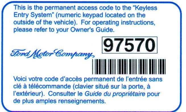

There isn't one on the ls. If you dont have the card with the code found in the back of the owner's manual, you have to take it to the dealer to get the code read.

Anyone have a picture of the card with the code on it? I'd like to know what it looks like

I've read the number is on the keyless module in the drivers door. I had a buddy read mine with a Ford scan tool. Turns out my card was still in the owners manual. I should have looked through it first!

not as written ON the the DDM, it is written IN the DDM, thats why it need to be scanned to get it. no one has ever found the code written down anywhere other than the keyless card (for the LS anyway)

If you don't have the original credit card that came with owners manual you have to get it scanned everything else is :bsflag:
