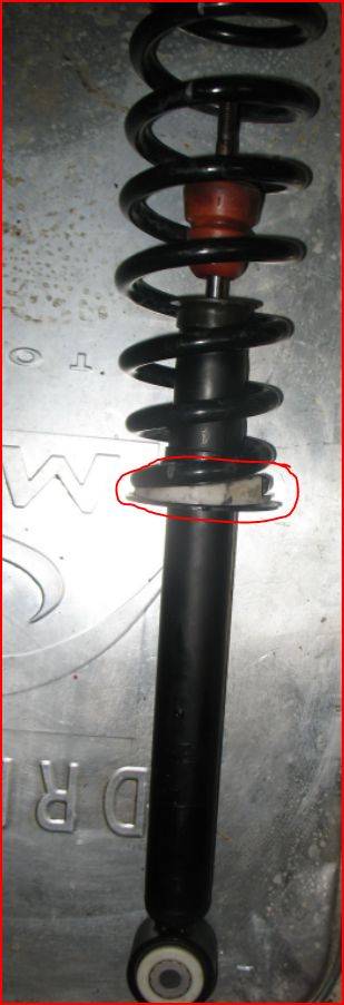

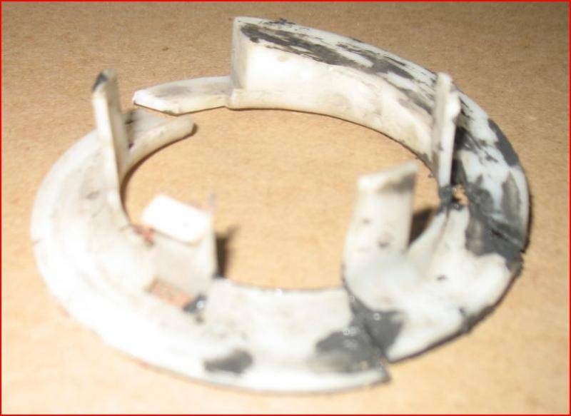

I ran into an issue changing the front shocks on my 2000 LS. When removing the coil springs from the shocks I noticed the "white plastic coil spring insulator" the coil spring (that sits at the bottom of the coil spring between the coil spring and the shock flange) was broken in two pieces. Then it fell off the shock to the floor and broke into 3 pieces. It was brittle. I called the dealer but they apparently don't list these little plastic spring insulators separately and he said they must come when you purchase the coil springs themselves.
Anyone ever need to replace these "plastic insulators"? If so, where you able to find them? I can't seem to find them in the drawings.
EDIT: I tried to superglue it back together but wont stay together.

My mechanic friend suggested using a small piece of heater hose on the coil spring where it rides on the flange. I actually made a small plastic "gasket" for the flange the coil spring rides on to insulate it. I made it out of an old plastic engine cover (the one underneath the car to protect the bottom of the engine bay from rocks, etc.). I'll see how it works (or doesn't work) and try to post a pic of it later.
