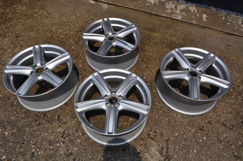

Wheel experts I need some definitive answers here. I found a set of refinished Volvo Atlantis (2003-2008 XC90) wheels here locally for a good price. I need to know for sure if they would fit. they are 18" x 7" with 59mm offset, so far no problem. I know the LS as well as these are hub centric but I cannot find information on the center hub diameter for either an LS hub or these Atlantis wheels.

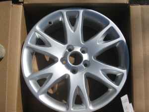

I dont have them mounted yet, I'm getting tires for them in a few weeks. They are xc90 wheels, from the v8 sport model, 19x8 46+ mm or 49+mm, I forgot which of the two.
Thanks for the offer and info. I'm off to check the wheels out later this week and I'll measure the ID. I used a conversion chart to get an idea of what to look for in a means I can measure. I'll let you know how I make out.

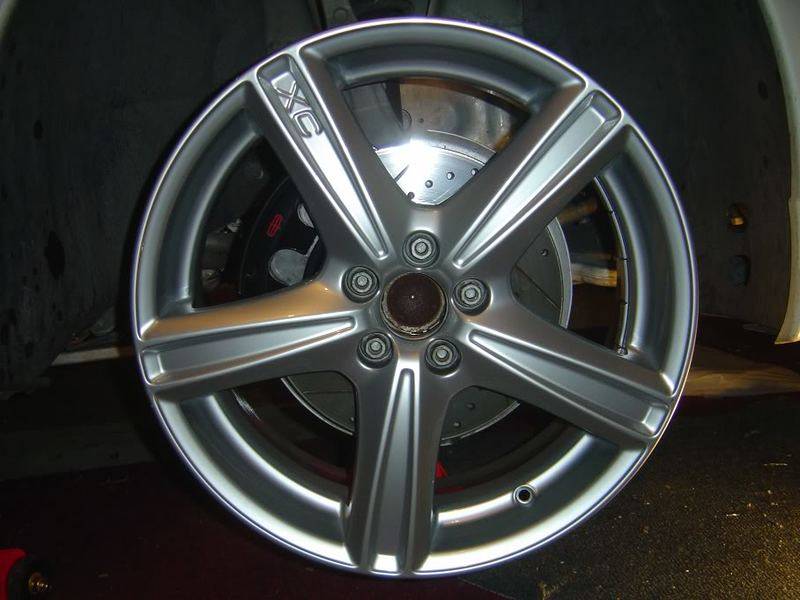

In my case, the hub size on the volvo xc90 is 3.7mm larger than the ls hub, so I need a 3.7mm thick ring to fill this gap. You can't use an ls rim on a volvo xc90 because it wont sit on the hub.
