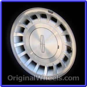

S SonOfThomp LVC Member Joined Sep 21, 2014 Messages 32 Reaction score 1 Location Austin Nov 11, 2014 #1 16x7, but what is the offset? Thanks
Markviiiedrea Speed Bump Joined Sep 20, 2004 Messages 4,746 Reaction score 168 Location Bloomington, MN Nov 11, 2014 #2 Same as a 1994-2004 Mustang, 31mm offset. They will fit any town car up to 2002.
S SonOfThomp LVC Member Joined Sep 21, 2014 Messages 32 Reaction score 1 Location Austin Nov 11, 2014 #3 Aren't stock Mark VIII wheels 39mm offset? It sure looks like more than an 8mm difference.
slowmkviii Dedicated LVC Member Joined Sep 28, 2007 Messages 5,719 Reaction score 170 Location Elk River, MN Nov 14, 2014 #4 Stock mark wheels are 39 And i believe that that original Pic is 30mm not 31.
